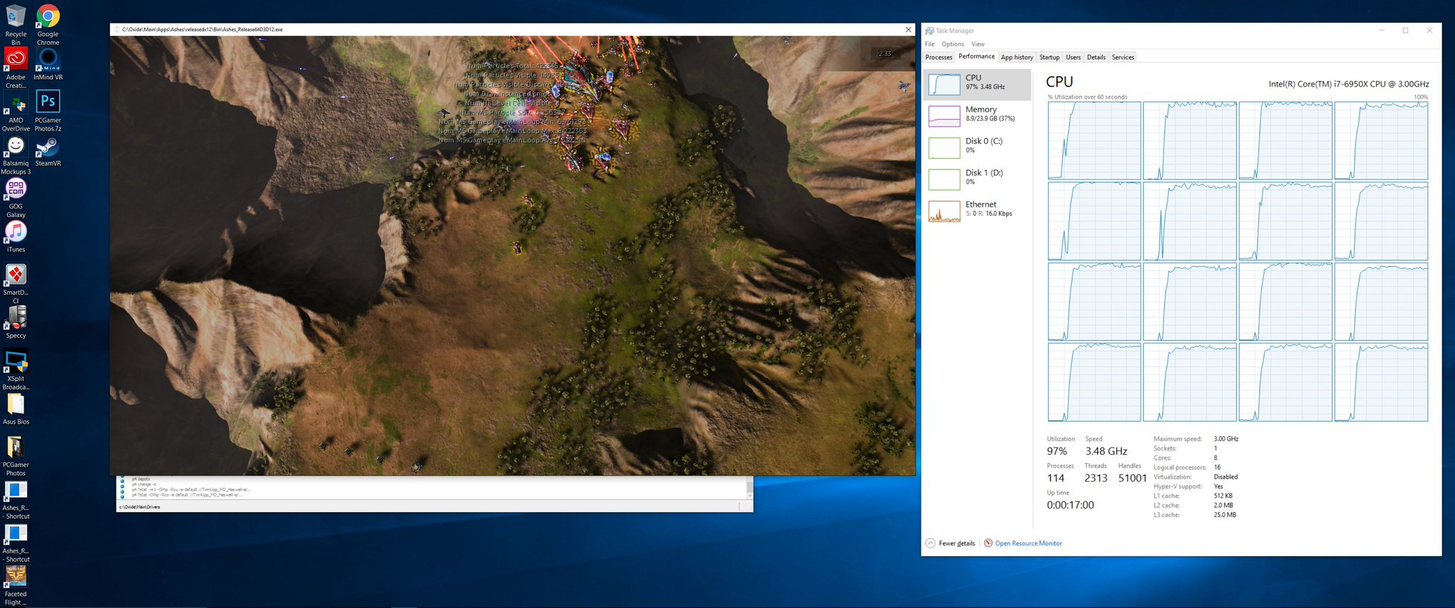

I'm just asking you to confirm it,task manager shows the average usage of each core over a period of 60 seconds...
Process hacker will show you the threads in (almost) real-time.
Not really sure what i'm looking at here but just downloaded Process Hacker and took a screenshot of the Threads tab while running a benchmark in Ashes:

Bump...someone who knows Process Hacker well can you tell me how many threads are running from Ashes in the screenshot above?

Taken with his previous statement that would mean 16 cores with multithreading would be up to 32 threads. So possibly he meant it was limited to 16 physical cores and 32 logical cores. But I never heard that on the official forums. Either way, the graph posted on that thread clearly looks like the game is not utilizing the 2nd CPU so I suspect something else was preventing him from using more than 16 threads. Even on my setup the game loses some multithreading efficiency when using the 2nd CPU but it still scales to around 18 threads for me.
They are likely pooling threads. They make n number of threads on game initialisation and then they dispatch, dispose and reuse them when needed. So yes, you are somewhat correct about there being a ceiling on the number of threads they can use at once, we just don't know how many to be exact. Also, games don't know whether or not tasks are run on a physical core, they only know the total amount of threads they can use.
TheELF
Dec 22, 2012
3,967
720
16 threads(1main thread+15 worker threads) + the xaudio one equals 17 threads total.
The rest isn't doing anything so it's not counted,they just keep files open and stuff like that.
Now I'm not really sure on how it measures HT usage but 12 real cores would amount to each core being 8.3% of the total cores,so a thread running at 8.3% would mean that it runs on 100% of this one core.
(if HT is counted as well you halve these numbers)
Point being that all threads have a low utilization because that's enough for the GPU you have and there would be no difference with fewer cores and higher utilization.
Actually,
A few months back I tested this game limiting the number of threads and the effect on performance.
I ran the test again twice, once with the games Affinity set to only use 8 threads and the other allowing all threads to be used. Here were the out comes:
8 Threads Test:
All Threads Test:
Since this game (like most games) is mostly GPU limited there was a very small change in overall FPS. Fortunately the DX12 benchmark breaks out the CPU performance and shows a 18% performance increase when utilzing all of my systems threads instead of limiting it to only 8.

The fact that you don't understand that this does not necessarily mean that every core with usage you see equals a thread is not my problem. You are equating the dev statement with something slightly different. It is still possible that your GPU is holding back the performance and that the game has no need for x threads and is really running at x-1 where x is the number of cores you see used but it has just moved one of the threads to another core to balance.
What I said was just because you see usage on a core does not mean it has its own thread, you cannot simply look at performance in task manager and count the number of cores with usage to determine the threads. That statement stands.
Looks like you were wrong.
