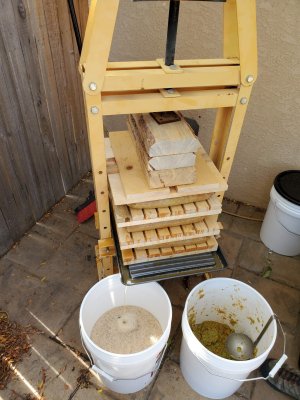

i built a cider press out of a hydraulc shop press. I think i have 2 or 300 in the whole setup but we can process several hundred lbs of fruit in short order with 3 people. a cutter/stemmer, a grinder and a presser.

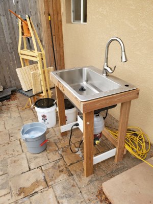

thrift store sink and faucet with 2hp garbage disposal for grinding the fruit into buckets. The mash went into mesh bags that get stacked with the slatted boards you see sitting on the press. about 3 bags per pressing. go slow or they will explode. I bought a large sheet pan with ribs and a trough around it, i think marketed for bacon, drilled a hole in a corner for collecting and draining the cider into a bucket. We made the most amazing fruit wine from our very old apple trees and our pear tree.
