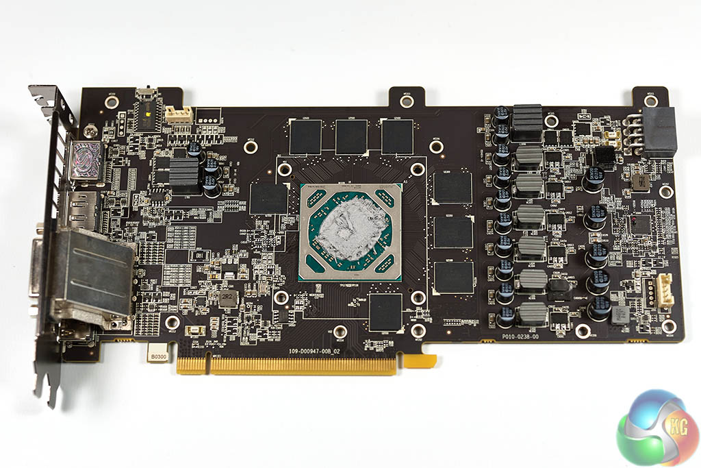

SK10H
Jun 18, 2015
114
44
101
I'll just caution that I actually expect it to be 4GB physical, with 7GHz chips. It would explain the 1 month delay for custom cards.
Of course, if it isn't one or both of the above then I'll be sure to post letting people know.
http://www.kitguru.net/components/graphic-cards/zardon/sapphire-rx-480-nitro-oc-4gb-8gb-review/2/
Reviewer who doesn't know what people want to see... How hard is it to take a picture of the memory chip if the card is already naked instead of just mentioning hynix GDDR5. :oops: The memory can't even clock to 2000.
Sapphire should have just sent you the card for review instead. ;)
IEC
Jun 10, 2004
14,343
4,949
To date, there have been no 8GB cards with slower than 8Gbps GDDR5.
As for the 4GB Nitro+ model, it looks like it is confirmed to be using 4Gb, 7Gbps GDDR5 by various reports and reviews, where it failed to OC to even 8Ghz levels (usually 7.2-7.8). I've canceled my preorder as I don't even have an ETA on when it will ship.
