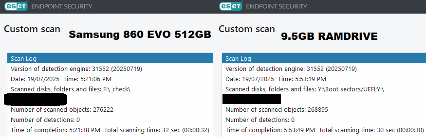

Well, the Eset Antivirus scan experiment was kinda disappointing. Scanned a 7.5GB folder of mostly documents, some archives and some EXEs (5000+ files). Scan completed in less than 5 seconds and CPU utilization didn't go above 30%. Next tried a 1.31GB ASP.NET folder (14000+ files) and this time, it briefly spiked to 96% or more but again the scan completed in less than 10 seconds. Not sure which file types are causing it to spike high.
Really making me wonder why the full PC scan is taking 30+ minutes with high CPU utilization when these tests show it can whizz through at least 1000 files a second. Maybe the stupid automatic Administrative scan is checking extra files that the normal scan doesn't do 🙁

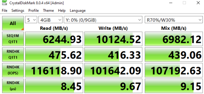

This test confirmed that I'm CPU limited. The only thing RAMDRIVE did was max out the CPU cores completely at 100% while taking roughly the same time to scan the files while the SSD allowed the CPU to breathe a bit in between waiting for I/O.
RAMDRIVE Benchmark
Ramdrives tolerate very high queue depths at the expense of the processor time required to actually administer the drive. It inflates your processor usage quite a bit. The happy medium is an optane drive. It tolerates very high queue depths while having a higher transfer rate than the SATA SSD, but also has it's own controller chip, which takes a chunk of the load off of your processor.
