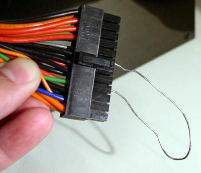

The PSU fan doesn't turn on when I turn the power on. How do I know this PSU is working?
You need to connect the PSU to a MB and start the MB to check the PSU. Connecting the PSU to the wall and turning on the switch at the back of the PSU will not do anything.
There's a way to start it up in simulating the closing of the power switch by shorting two of the pins on the ATX connector. Not sure off hand, but I'm sure someone will be able to chime in.
