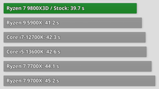

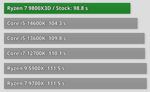

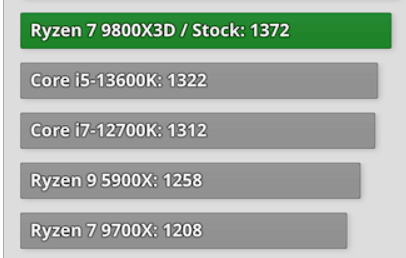

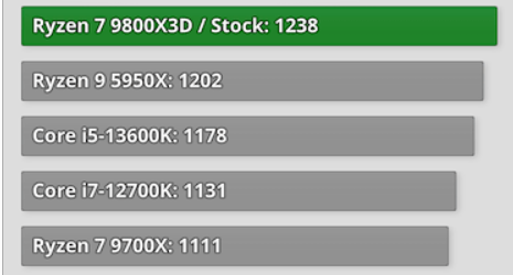

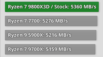

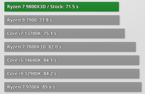

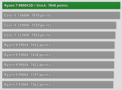

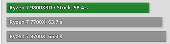

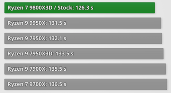

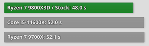

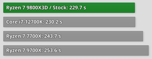

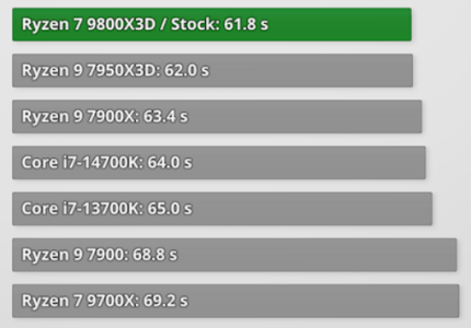

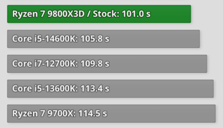

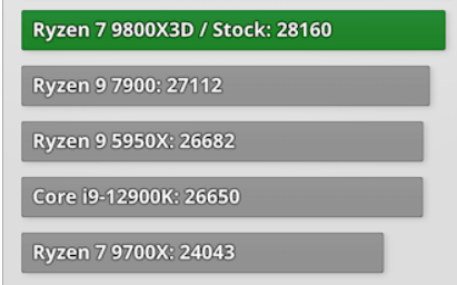

My understanding being, the V-cache is keeping the cores fed with data, reducing their idle time and increasing their throughput. More RAM channels would remove the cap on data size and the CPU wouldn't have to deal with data feeding delays due to V-cache running out of space.
Don't forget, that V-cache also keeps the instructions. It will help cut front-end latency. And C&C noted in their reviewes that front-end latency is one of the biggest problems of Zen5.
