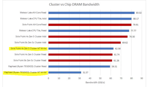

Can you prove they are BW and not latency limited?🙂
If Strix Halo doesn't have V-cache and the final Strix Halo silicon beats 9950X in some benchmarks and assuming it has nothing special outside of being vanilla Zen 5 arch, that would be proof that the cores are bandwidth starved.
Yes comparing results between Halo and 9950X should reveal BW bottlenecked workloads. Halo should lead in those. For example Halo should be at least 2x-3x faster in LLM inference run on CPU, thanks to having the BW advantage.
