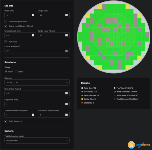

I think some people are overestimating how much Strix Halo costs. It isn't that expensive. Plugging die size for the GPUIO die into a calculator gives 148 good dies. At $17000 per wafer, that's $114.86 per die.
The CCDs are around $20 each. Even after the advanced packaging, the SKU costs less than $200 to manufacture.
