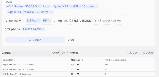

Should've used RDNA4 for Strix Halo, not fast enough for Blender. The 8060S is just 10% faster than the base M4.
Isn't that more of a software problem? Apparently 8060S should be comparable to RTX 4060, and 4060 is benching much better in blender. I doubt RDNA4 would have helped.
I don’t believe it’s a software problem, hardware RT acceleration using HIP is supported in Blender.
I could be wrong here, so we’ll just wait for the 9070 XT results.

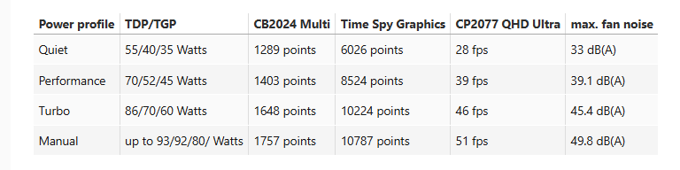

Strix Halo in Asus ROG Flow Z13 managed 10224 points in Time Spy Graphics at Turbo power profile(TGP 60 Watts). (Link)
RX 7700S(2.5GHz boost and 2.2GHz gaming frequency) at 100W? managed 10206 points in Time Spy Graphics. (Link)
RX 7600M XT(2.6GHz boost and 2.3GHz gaming frequency) at 120W? managed 10777 points in Time Spy Graphics. (Link)
The funny thing is that even desktop RX 7600 manages only 10,771 points in Time Spy Graphics. (Link)
I will ignore Halo's score at 80W in TimeSpy, because It looks like It's already bottlenecked by gaining only 5.5%, which is interesting considering in CP2077 they still measured a 11% increase in FPS moving from 60W -> 80W TGP.
It looks like the IGP worked at ~80% of 7700S's clockspeed(32/40CU = 0.8 or 80%) so somewhere between ~1.8GHz at 60W TGP, assuming 7700S has 2.2GHz during TimeSpy.

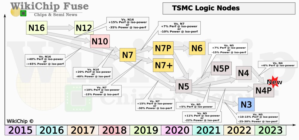

Not sure If that IO die uses N4 or N4P(N4X), but If the above graph holds true, then moving from N6(N7P) to N4P should give you -39% lower power consumption or 19.3% higher performance(clockspeed).
With this in mind Halo's 40CU IGP doesn't look very impressive, because 7700S ported to N4P would mean 61W TGP(100W*0.61), so only 1W more while being disadvantaged by clocking higher.
