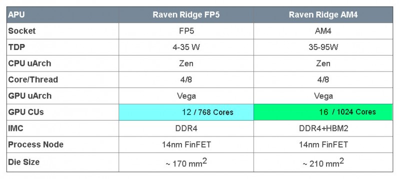

With 8MB L3 taking up just 16 sq mm I don't think AMD cut L3 cache by half for Raven Ridge. If they did so its not for area benefit but probably for power benefit. AMD might have weighed the perf loss and power reduction and deemed the tradeoff worthwhile.
Raven Ridge seems to be around 210 - 220 sq mm. I doubt its as big as 240 sq mm.
http://www.bitsandchips.it/52-english-news/7622-rumor-two-versions-of-raven-ridge-under-development
https://techreport.com/forums/viewtopic.php?t=119682
