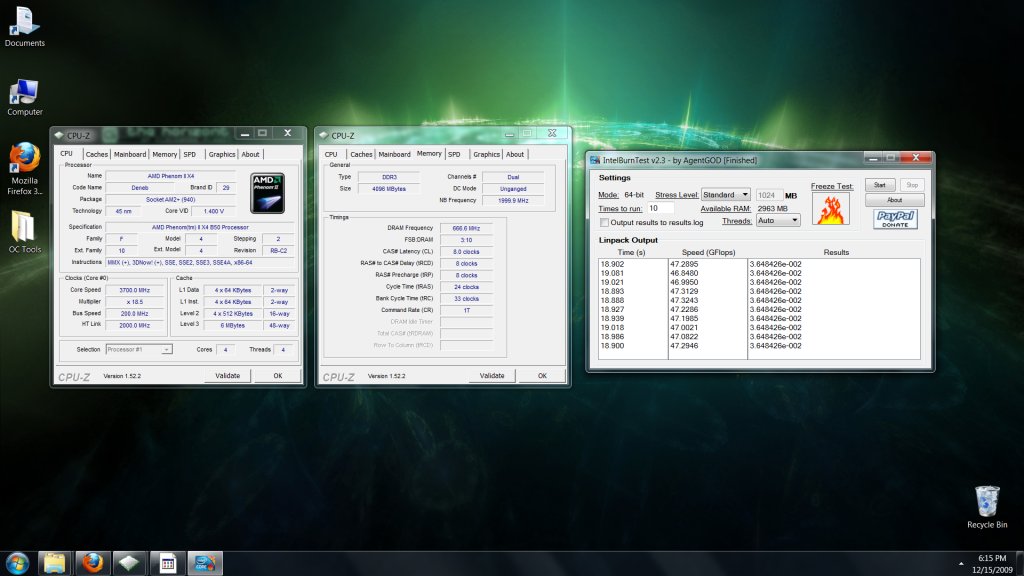

Just got this chip yesterday along with a new motherboard and ram. I got this chip with high hopes of unlocking. IT WORKED! This is pretty sweet chip. It's my first real oc'ing chip and so far so good. Thus far, I'm up to 3.7ghz @ 1.4v just changing the multiplier (18.5x200). I've also been able to tighten my memory timings from 9-9-9-24 to 8-8-8-24. Intel Burn Test stable through 10 runs on the Standard Stress level. However, I have been unable to view temps. RealTemp and CoreTemp both fail to recognize the processor. Any suggestions on an alternate way of getting this other than bios? Anyway, I just thought I'd share this for those who may be interested. I plan on tinkering with it more. Again, I am pretty new to OC'ing in general, so any tips or suggestions would be awesome!
Screenshot 🙂
http://i171.photobucket.com/albums/u301/codyray_10/4core37.png

I'm not sure of the stepping and batch code, unless my screenshot displays the stepping/revision correctly. Which I'm not sure if it does because its now recognized as a different cpu. As for the motherboard I'm using, Asus 790X Evo seen here http://www.newegg.com/Product/Produc...82E16813131402. I didnt even boot the cpu as a X2 at all. As soon as I had finished the build I went right into the bios set ACC to auto and turned unleashing mode on and set to 4 core operation.

Very nice. Mine doesn't seem to be as stable as I first thought. The other night it ran IBT stable 10 runs @ 3.7ghz but now it wont do the same. I've had a few BSOD's but currently am stable @ 3.5ghz/1.4v with memory timings 8-7-7-24. I imagine one of the cores isn't completely stable, trying to narrow it down at the moment. Going to try lowering the multiplier on the problem one when I get an idea of which one it is

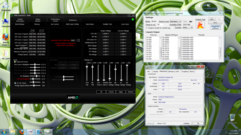

Now overclock the CPU-NB, I've added +0.2v and run it at 13x200 for 2.6ghz. If you can get yours up to 2.5-2.7ghz you'll gain another 10-15% in performance across the board-- gotta keep the cores fed with data!

I was going to ask about overclocking the NB. Does the CPU-NB have it's own separate multiplier? I've been using AMD Overdrive for most of my testing, and havent been sure where to add a little extra voltage. I've only adjusted cpu voltage and cpu/fsb multiplier.

I did my OC'ing in the BIOS. That's where the multi for it will be.
You can use PhenomMSRTweaker to set voltages and multi's for idle/load. Keep in mind those voltages are in reference to the voltage you've set in the BIOS, so anything below the default setting in PhenomMSRTweaker will be (BIOS setting - Default voltage setting) lower than the BIOS voltage.
Weird issue, it doesn't seem to like to cold boot. After it's been shutdown for a while, when I try to boot it, it BSOD's. This has happened the past two days when I come home from work. Once I get it up it runs fine. I just passed 20 IBT runs stable using 1024mb ram. I passed it with cpu @ 3.5ghz/1.4v, NB @ 2.4, 9-9-9-24 (stock) memory timings.
Screenshot: http://i171.photobucket.com/albums/u301/codyray_10/4core35.png
edit: whoops, cpu-z is on mainboard tab ;\
