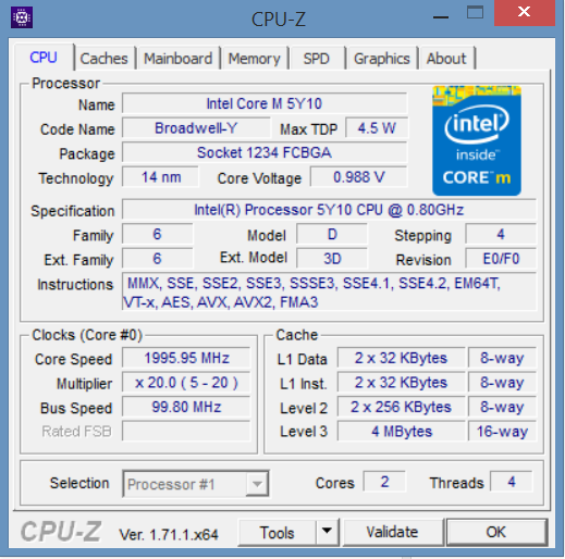

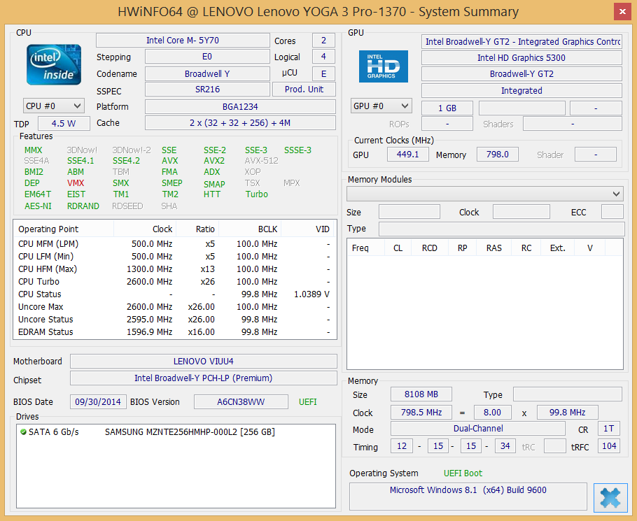

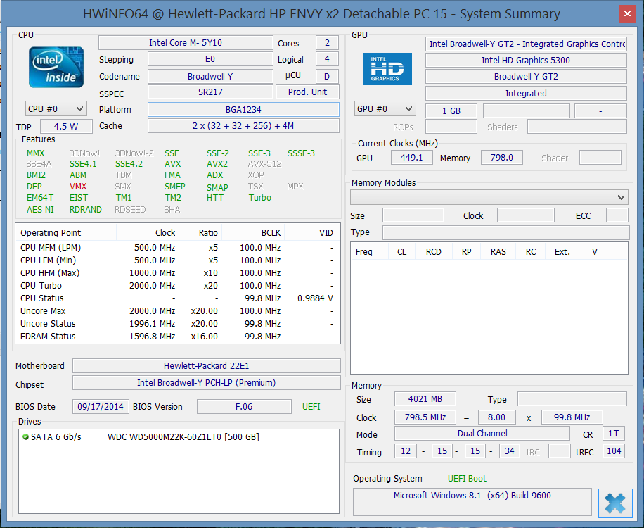

All you've done is quote the maximum possible short-burst Turbo OC voltage, not it's normal operating voltage. Either you didn't bother to read the article you're quoting, or you simply aren't honest enough to quote the context of the single images you're posting (as you've been caught doing before):-
"Notice however that the maximum Turbo clocks are the same - 2.60 GHz. Intel told us months ago that Broadwell-Y was designed to run at extremely low power and clock speeds when idle but still reach high performance and high clock speeds on demand, when needed, in short bursts. Most importantly, note the significant TDP difference between these two processors. The Core M 5Y70 only requires a thermal solution designed for 4.5 watts. The Core i5-4200U required a 15 watt system design - more than 3x the potential heat to dissipate.
The Yoga 3 Pro with the Core M 5Y70 is able to pull out a result that is 8% longer than the Core i5-4200U. That's great and all, but is made even more impressive when you learn that the Yoga 3 Pro has a 22% smaller battery in it! Lenovo shipped the latest Yoga machine with a 44 Whr battery compared to the 54 Whr battery found in last years Yoga 2 Pro."
http://www.pcper.com/reviews/Proces...ance-Testing-Broadwell-Y/Power-Consumption-an
Nice noticeable increase in battery life for a chip that (according to you) "uses more power" based solely on its max Turbo OC voltage state that it spends less than 1% of its life in. :thumbsdown: :rolleyes:
