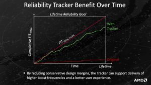

I wonder what these might be. The dies are identical (as you've seen) and most of the low-level software is identical / shared too (microcode, co-proc. FWs etc). I believe the difference is purely in SW configuration, if there is any in the first place.
The situation is different on Stoney Ridge, which is also a 7th generation APU. It is a new die and there are hardware changes (security processor, UVD).
The AT article contains some slides, incl. this one:
http://www.anandtech.com/show/10362/amd-7th-generation-apu-bristol-ridge-stoney-ridge-for-notebooks
What I had in mind was this:
The Stilt
Dec 5, 2015
1,709
3,057
That's interesting. I wonder if they've actually gone back to GF28A instead of GF28HPP on Bristol Ridge. I don't think it is likely that they spend a single additional penny on a dead design / microarchitecture at this point thou.
But it the otherhand, they did create Stoney Ridge too. Impossible to know what these people are thinking.
Technically they could achieve the same "improved process" through simply binning the silicon better. The best silicon for BR and the rest for Carrizo. I could produce similiar "improvement" chart on FX-8800P by simply undervolting.
In the other hand, the production scale in terms of VDD vs. Frequency on BR is the same or even higher than on Carrizo.
I think, there are bigger differences between GF28A and GF28HPP to switch that easily. What I wanted to show with the older slides is, that a process could be tuned in a steady improvement process.
See http://www.anandtech.com/show/2018
But that might also simply be the yield learning curve.
