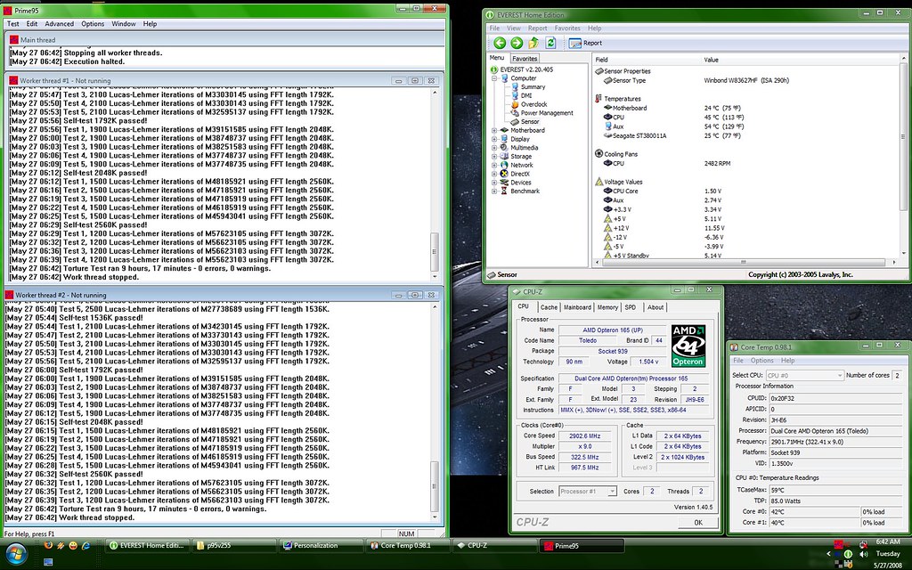

I have an Opteron 185 in an ASRock 790GX board for 939 and DDR1. I never attempted to max out the OC as I picked it up on Ebay to replace the 165 I had been running at 2.6Ghz, but I got 2.8Ghz out of it without any real effort.
EDIT : Ooops, memory fail, I got a 180 not 185. It is running pretty at 2.8Ghz though.
BUnit1701
May 1, 2013
853
Remembered I had a picture from an OC contest I was involved in over on the Tom's forums back in 2008. I never had the guts to go past 1.5V so couldn't ever get past 2.9Ghz on that old 165. I wanted 3.0Ghz so bad...
