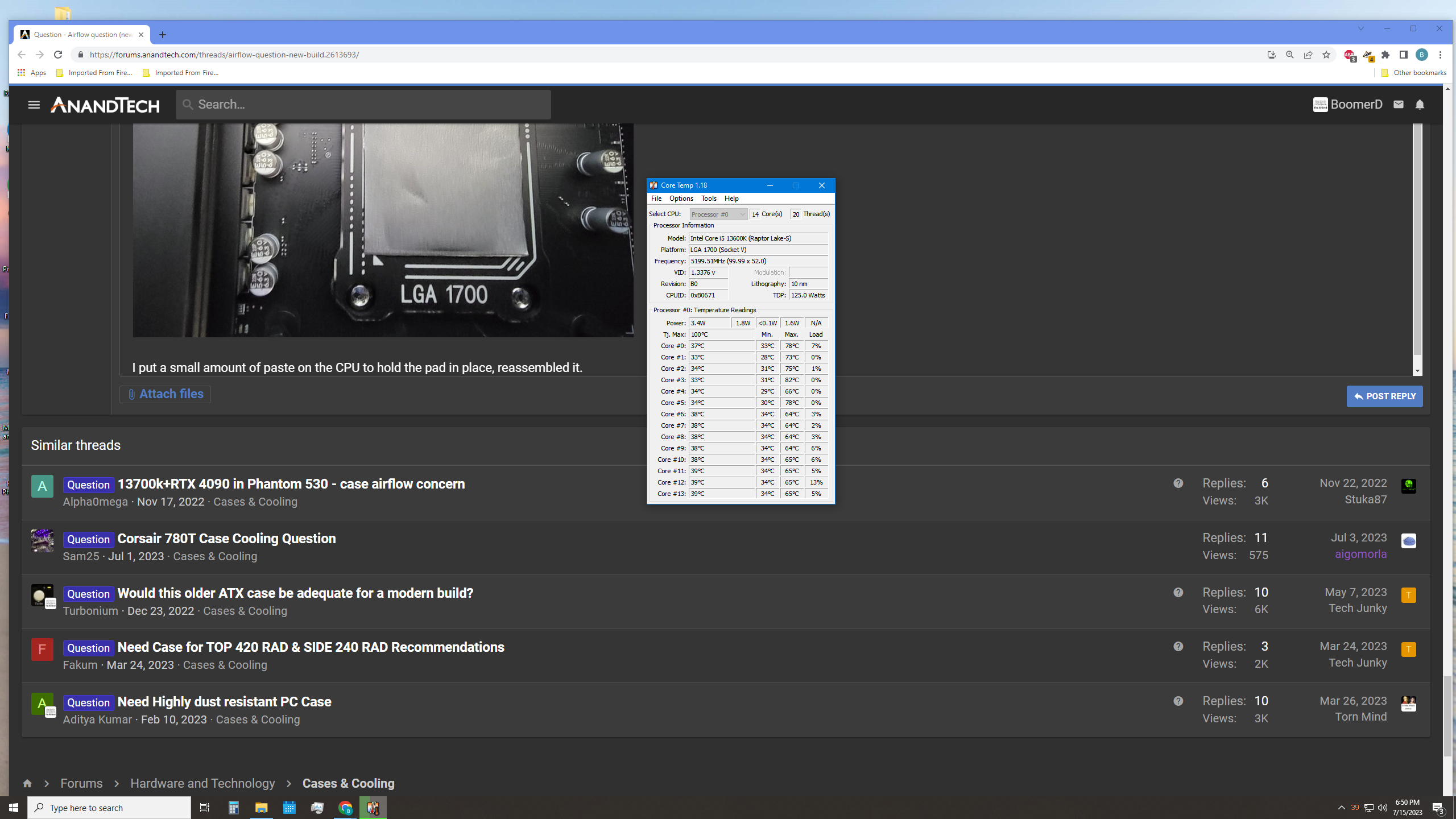

The graphite pad actually looked pretty good.
I put a small amount of paste on the CPU to hold the pad in place, reassembled it.
Temps still aren't what I'd expect them to be...this pic was taken about 10 minutes after rebooting:
Granted, they're not "set my PC on fire, but with only the basics of cold booting, they seem a bit higher than they SHOULD be. I'm actually beginning to wonder if the Thermalright contact frame is preventing the pump base from making solid contact with the CPU.

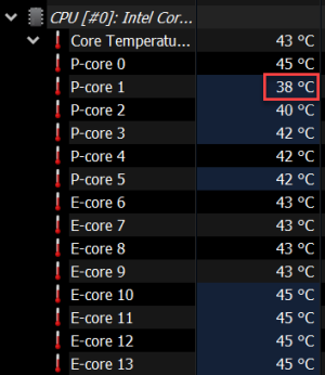

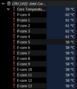

Here's what I'm seeing on my 12700K - Server
12700H - Laptop
Noticeably different due to the casing and cooling between an ATX case and a laptop. The pad does a good job keeping the GPU in the laptop under 70C though under load. I can get the temps down on the laptop CPU by killing some processes but, this is with normal things open like Chrome w/ tabs and minimal fans running.
Laptops are a bit more difficult to deal with since the heat sink runs from side to side and pulls heat from both CPU/GPU w/o isolating them.
Running the fans at 100% drops the temps by 20C+ with all of the same stuff open as before. but I don't tend to run them at 5K RPM's just for the sake of a chilly CPU / GPU. So, there's some factors that play into how things tie together and the results of the pad vs paste.
