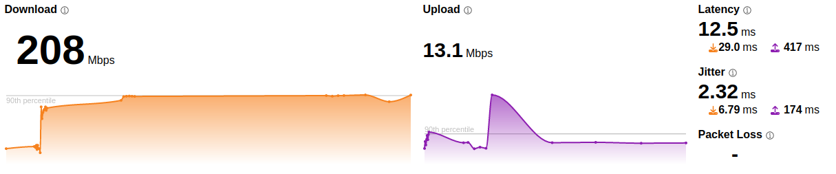

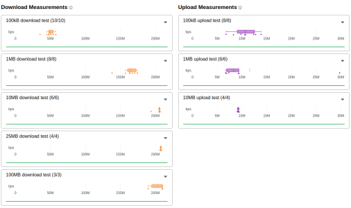

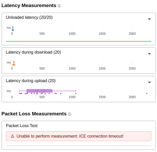

The last result went through last night. Maybe the problem is discriminating routing. Or maybe it's the high latency of my connection (>400 ms average and >1000 ms max during uploads).
Here are results of my home connection with https://speed.cloudflare.com/ towards a server in Berlin; I get basically the same with a server in Munich.
(Another try came up with 0% packet loss, 1000/1000 received.)
Last time I checked, other locally available providers offered slower upload for more money. Need to check again.

It's no use.
I made two results today but can't get them sent. The client repeatedly reports the transfer as failed, after a random upload percentage.
Yet my connection quality is still as reported in #15 when measured with https://speed.cloudflare.com/.
In addition, I took a traceroute to two work servers and one collection server of F@H, while there was no transfer was going on. The traceroutes showed ~16…20 ms when it got to Frankfurt, and jumped to ~105…110 ms on the very next step when it got to either Boston or Philadelphia. From there, latency practically didn't get any higher when the last responding hosts in the routes were reached (hosts at lightower.net in the route to one of the work servers: 131.239.113.97, and at upenn.edu in the routes to the other work server: 158.130.118.24 and the collection server: 158.130.118.26).
Going by the cloudflare measurements, I don't see that my situation would improve if I booked a VDSL link instead of my current DOCSIS link.
So, uploading 30 MB to PrimeGrid is fine. Repeatedly. And sometimes several of those in parallel. But getting 24 and 35 MB uploaded to F@H, even just one at a time, is near impossible.

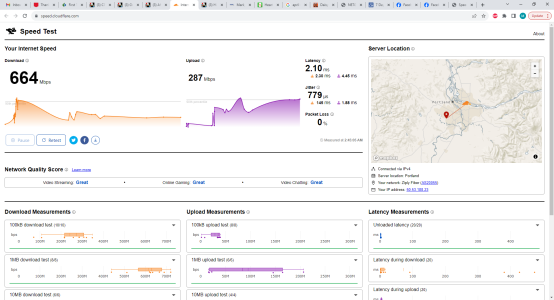

I really wish I knew something about the technical side of networks, so I could help you, but my hardware knowledge is how to assemble PCs, and thats about it.

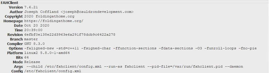

PS, I've got fahclient_7.6.21_amd64.deb, i.e. the latest according to https://foldingathome.org/start-folding/, on Linux Mint 21.1.
This is linux mint 20.3 from ps -ef. Not sure how to relate that to your client version.
root 214762 1369 0 13:35 ? 00:00:00 /usr/bin/FAHCoreWrapper /var/lib/fahclient/cores/cores.foldingathome.org/openmm-core-23/centos-7.9.2009-64bit/release/0x23-8.0.3/Core_23.
root 214766 214762 99 13:35 ? 00:29:40 /var/lib/fahclient/cores/cores.foldingathome.org/openmm-core-23/centos-7.9.2009-64bit/release/0x23-8.0.3/Core_23.fah/FahCore_23 -dir 01 -
StefanR5R
Dec 10, 2016
6,855
11,037
It's FAHClient which is doing the data transfers. FAHCore only performs the computation. FAHControl's "System Info" tab shows the client version, for instance.
