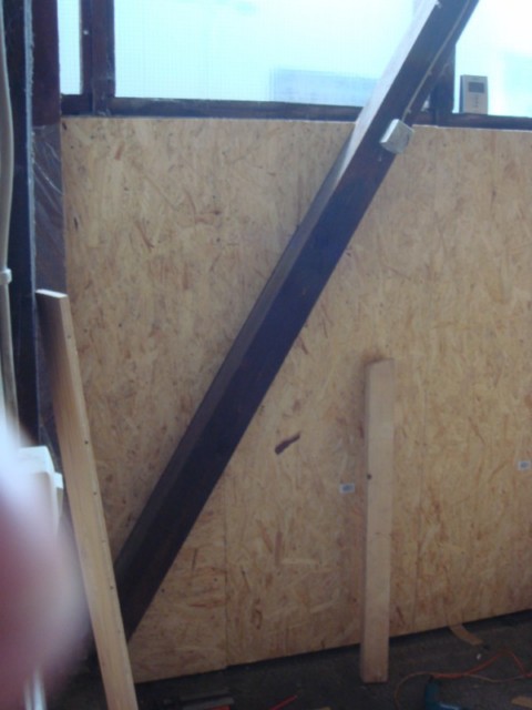

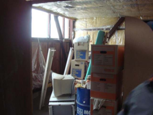

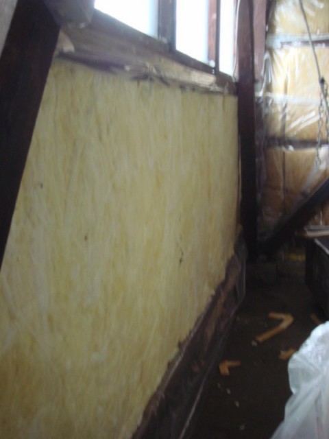

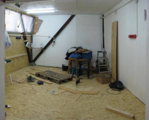

the room for the new workshop at the beginning looked like this:
Storage -.- good that vacuum cleaner exists ^^
The wall you can see here is the wall to the outside.

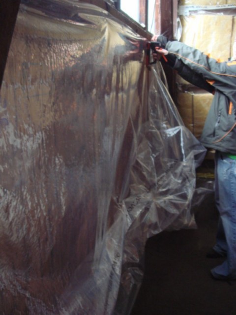

We have embedded a couple of thick fiberglass mats so it's not going to be so cold in winter.
it is finally a more lighted workshop ... This is much better than a cellar:)
over the fiberglass mats, was stapled a protective film

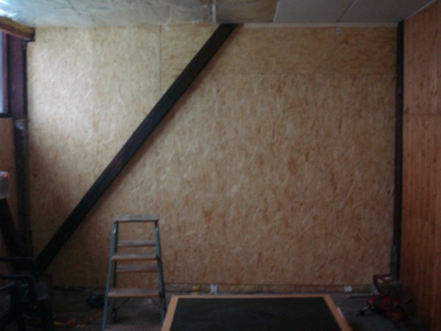

then we started with the casing:
here the first wall is finished:
That was't this easy with the 2 oblique beams

and here the second wall

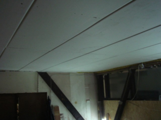

Then we started with the ceiling, here is Finn tightening the plates of Rigips
it was the first time we did something
of course, have forgotten the smal beams under the Rigips-plates -.-
otherwise it would have been much more straight..... annoying
While this here looks like total disability, but I'll show it ....
forgot the tissue-bound and the mixture was not the right thing ...
afterwards a friend of mine came over and has corrected our faults ^^

here 2 full surround views:
http://anfi-tec.de/forenbilder/ausbau2/gr9.JPG
for a large view, click on the link under the pictures.
http://anfi-tec.de/forenbilder/ausbau2/gr10.JPG

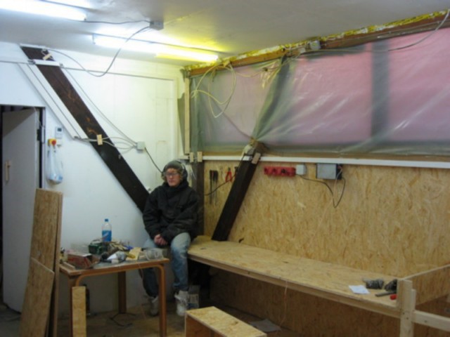

it was -10 ° C outside and this we noticed by the single-glazed window -.-
so finn taped a thick foil in front...it worked very well

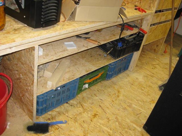

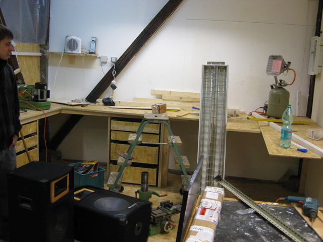

Then they went on with the inside working
First made a couple of drawers
which lend themselves well as a surface to do the cuts
and the first factory-bank (with sitting-height) was finished
it is dark outside ... more red :D and the 2 workers are exhausted

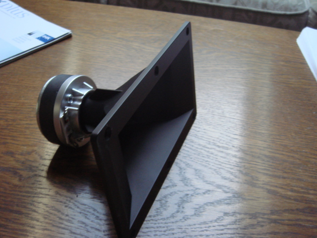

I had 2 large PA speakers left, but the tweeter were broken
opened and located
the small hair-wires were torn down at the focal points -.-
very thin
So out of that glue
soldered a new thicker wire
Top out again, and solder them
tested works :) - assembling

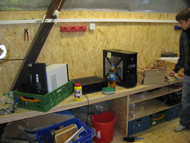

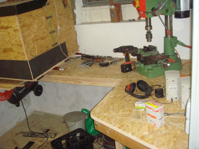

In the workshop it went on.
all the drawers were finished and the workintables were completed
stuff-boxes
many other stuff what we've transportet in the new workshop
and a new heater we bought too
computer for controling for cncs

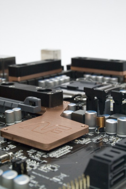

last but not least something for the watercooling-junkys:

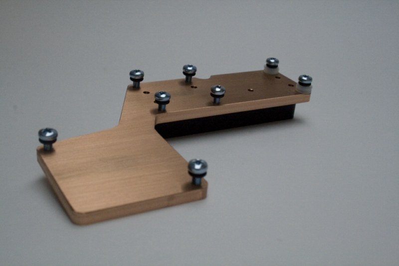

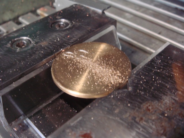

I once i have tested whether Soleil fullcopperblock can be produced economically:
I have 3 pieces of milled
View from below:
done (cut / thread / etc) from the bottom with Oring
upside
Andreoid
Nov 9, 2009
53
61
www.anfi-tec.de

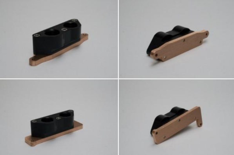

complete with bracket screws floor and then he looked like this:
We will keep the top here and investigate whether any material change has an effect on the performance of the cooler
in large quantities (economic production) as the Soleil POM-top can not produce the fullcopperblock with our current resources[/ b]
for everyone who does not know it yet:
Soleil01 with black pom-top
the problems in producing the fullcopperblock are:
the bevel on mice top
The countersunk screws
The threading ger G1 / 4 "thread (I do this by hand, because the cordless electric screwdriver is to weak)
greater tolerance transgressions because the production is simply too difficult to edit material as plastic
maybe we could produce fullcopperblock economically with the big cnc later, but then it would kill the time by changing the cutting-tools manually

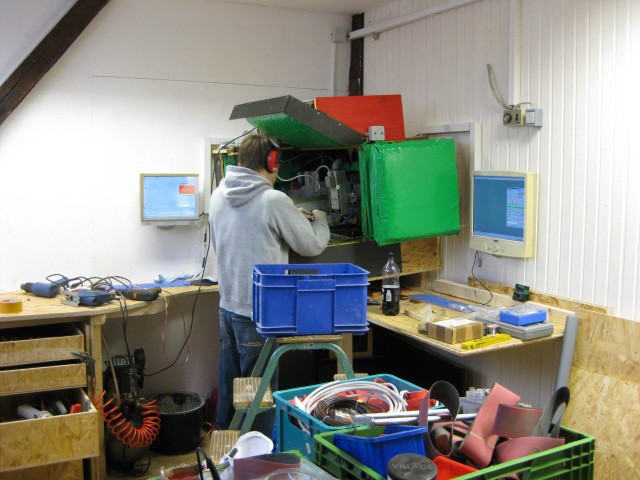

Continuing with the entrance into the workshop ... it had happened a lot.
The insulation-box has already been set up and the control PCs with monitors have been installed.
Works in comparison to the old workshop really lost in the space

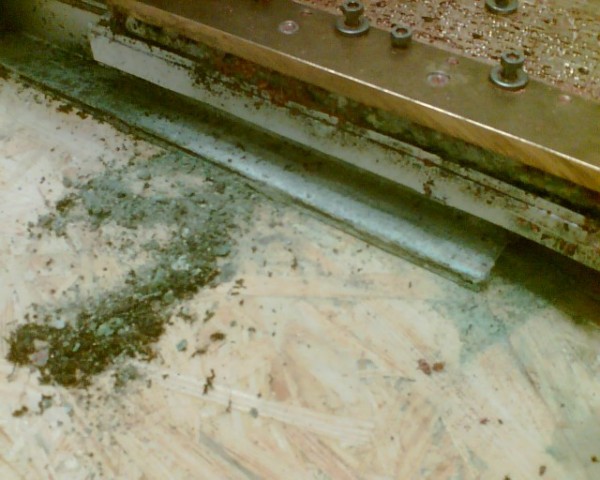

But before the CNCs were able to move back in the box, they had to be serviced in first.
The Model-aluminum CNCs dont tolerate the coolant for miling and the copper in any way.
The CNC base are totally corroded. Thus, a AluCNC is nothing for eternity if one manufactures waterblocks.
Then the machines into the box, and production begins ^^

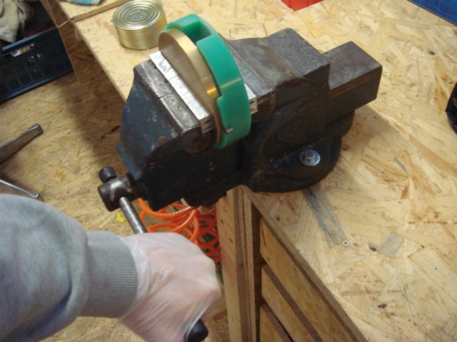

here sth new out of the new workshop :)
can you see, what this is going to be?

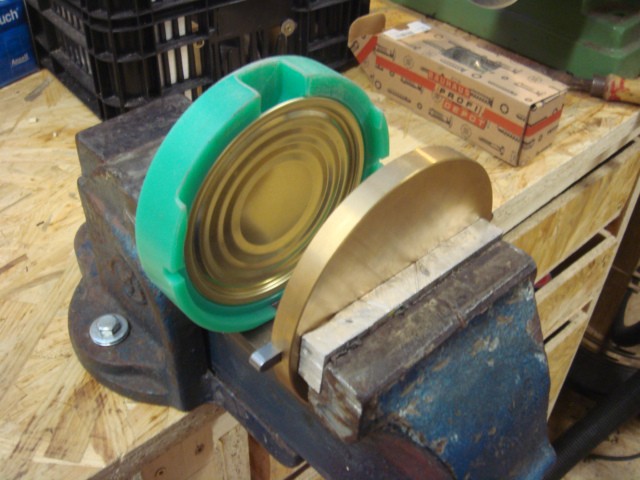

furthermore one need this caps
and a big strong vice
our Anfi-tec Logo as positiv form
made out of brass
and a opposite side out of plastic
in complete this is a logo-die ;D
put a cap in it
put the finger away
and turn off strong

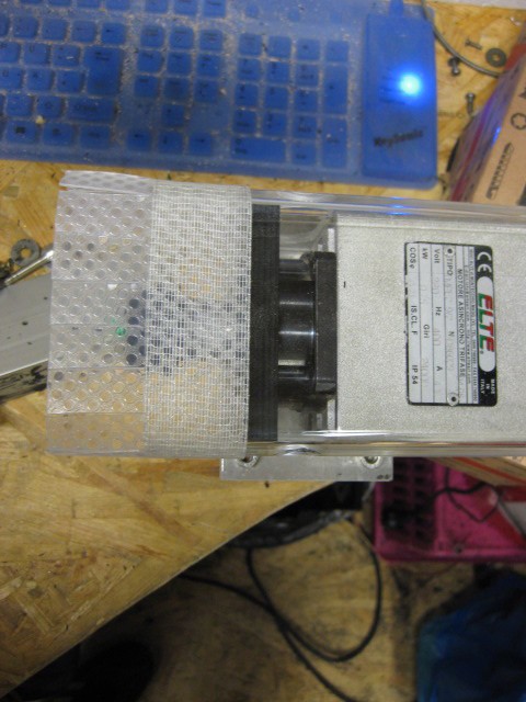

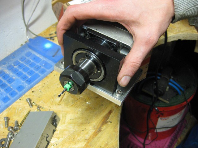

Today there are only a short on our CNC milling machine
We bought us a 2nd high-frequency spindle for the smaller CNC.
It has to be fastened.
I cut an aluminum plate and drilled the corresponding mountingholes:
The black rectangular plastic piece around the spindle neck is already an air lock made from Pom.
The spindle has a couple of air ducts for cooling and it's almost like a hair dryer.
In addition to the plate it does require a splash protection because of the coolant.
This should be placeable as quickly and practically, and not direct the air downwards.
So, a customized plexiplatte was formed with a heat gun
Drille the Holes for the air-outlets
and filed
Then we still need more flexible ...
Double-sided tape to fix:
Then something plastic film
The spindle with its holder looks like this:
Andreoid
Nov 9, 2009
53
61
www.anfi-tec.de
then the pom-air lock:
and splash protection:
protection simply stuck through with the stress of the plexi.
On the picture you can see the air ducts also:
and this will protect the whole when milling the waterblocks :)
regards [ΛF] Andreoid

Our garage get increases!

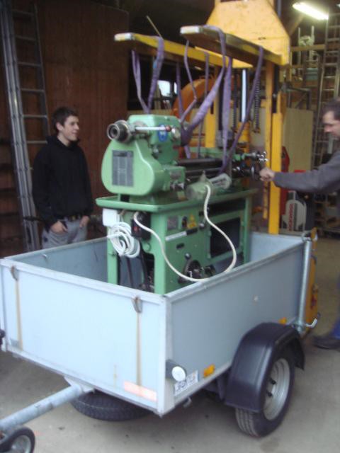

One of my former trainers has remind me in resolutiuon his hobby workshop
and had sold me its well-preserved Robling lathe:)
I've came along with a good buddy of me and picked up the lathe with much too small trailer.
On the ceiling is a chain was fastened to steel beams... the chain was, however,
hopelessly overwhelmed with the Turn, which we even had to let the air out of the tires.
The "Little one" probably weighs as to the 600-700kg.
Here the car, but .. not yet finished lashed.
Our dear neighbor has helped us with his ant to unload.
Now the lathe is on a pallet and wait to move into the workshop :)
Because this must happen before a proper foundation has yet to be cast.
This requires a bit of wood for a frame
Or direct a child's coffin: X
Andreoid
Nov 9, 2009
53
61
www.anfi-tec.de
Then removed the woodden ground with a circular saw at the appropriate place:
Now that's missing is the concrete, but .. that will come when it is a bit more warm.

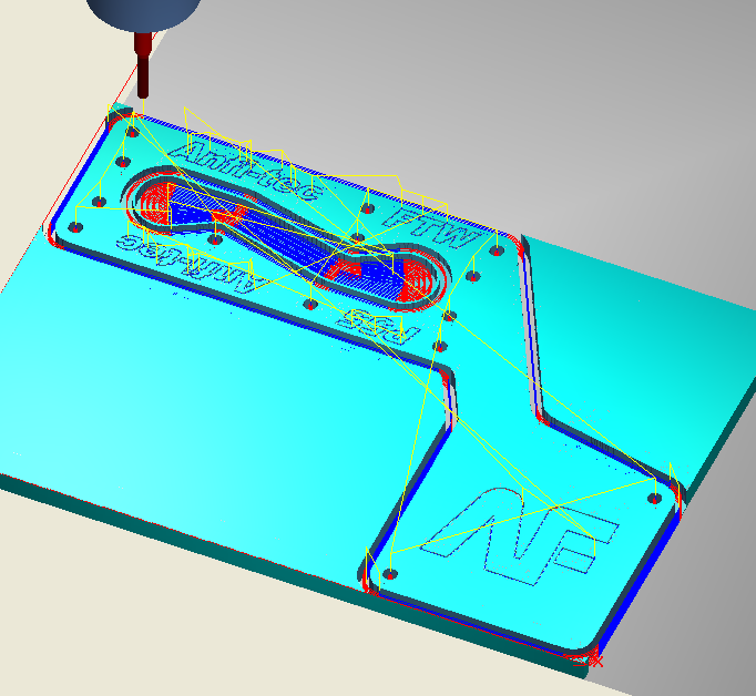

now i show you some waterblocks for the EVGA P55 FTW 200
the design of the NB / SB cooler at first looked like this
required after the first fitting of Plexidummys add another notch
and I have reduced the engravings somewhat...
well here you can see why:
here he is Finn assembling the cooler:
the NB / SB cooler does work like our last MSI 790FX full cover block:
(das Bild ist von dem LUXX User Schlingel_INV)
He uses the thermal conductivity of the copper
The SB does not have much heat and so a copper bridge is enough.
the woeld be only space for one channel, what you can see here
Then one of the fittings would have to sit between the graphics cards. -.-
The space for the voltage transformer cooler was not that huge,.. so I had to build up in the air because of the G1/4" connections -.-
At least I was able to continue to use often used tops ..
this not only saves my nerves ^^ furthermore it gives a consistent picture
what does EVGA think at the EVGA P55 NB fixings?
I do not know -.-
Never seen so many screws in a cooler, ..
Andreoid
Nov 9, 2009
53
61
www.anfi-tec.de

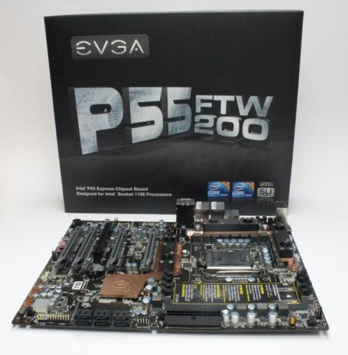

here are a few impressions with 13mm Dangerden fittings :)
like this picture
same in horizontal
http://www.anfi-tec.de/forenbilder/P55/8.JPG
et voilà
The Voltage Regulator waterblocks probably also fit on the standard EVGA P55 FTW
who else does have a P55 EVGA ftw can try one's luck ^^ with this http://www.anfi-tec.de/EVGAP55skizze.pdf
I'll probably need a photo tent, .. terrible dark pictures -.-
I'm sorry: D
btw... some more evga wbs,..but these are for an old 780i ftw :)
