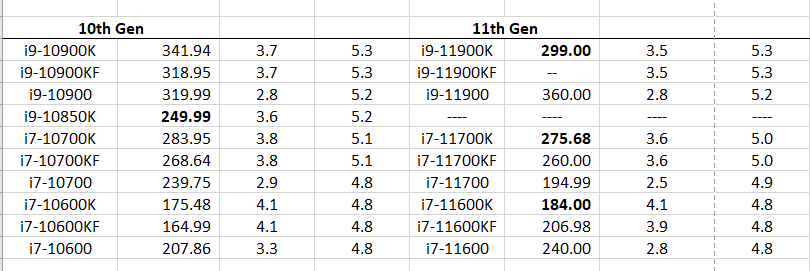

Now, what to do? 1. Easiest to do is to buy an 11th Gen chip to work on the refurbished Z590 board. 2. Return the new board for a refund, then take that money and buy a 12th Gen Intel or latest AMD combo from local Micro Center.
What is crazy is if I buy another i9-10850K CPU, which is one of the cheapest options, without going below an i5-10600K or i5-11600K., I'll spend around $200- $250. That money plus the refund gives me at least $320 to work with. I can add a little to that and get a i7-12700K, MB and RAM combo for $350, or an AMD R7-7700x, MB and RAM combo for $450. Both options give me features & speed I wouldn't get with buying a chip.

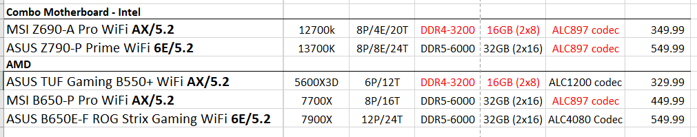

I'd like to get the system back up and running before the grandkids get here in 2 weeks. Before returning the refurbished board I did an excercise to see what a CPU would cost me on that platform. That was when I realized it made more sense to return the board and get something newer.
After my 15-mile bike ride this morning I started analysing the combo deals on MC. They seem to be putting some less than desirable boards with those combos. There was one that stood out as something I'd like to buy. Can you tell which it is?

No, but it looks like a target of $500.
If going Intel you should at least go with ADL or RPL like your second table. If you want to open the door for Gen 5 devices ASRock has a board that does both drive and pcie called the Velocita @ $350
I was looking at Intel as my broke stuff is Intel. So, I thought I just needed a new MB, but now it looks like the CPU was the issue. So, I'm open to AMD as well. I did rule out the stuff over $550 as this range is already more that I need.
:D
CPU, mobo and RAM are all great for the 7900X/ROG Strix combo. Guess you gonna go for that. Not a bad choice :)
Gets you probably Zen 6 about 5 years later too, on the same mobo.
Yep, that is the only combo that impressed me. Also, as you indicated it is a bit future proof.
I think I'm headed there tomorrow morning, assuming the wife agrees. ;)

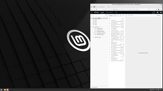

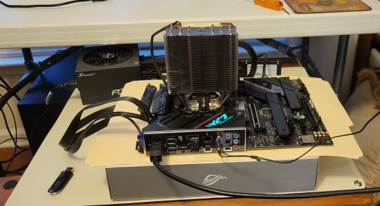

I picked up the Ryzen 9 7900x combo yesterday. I miss the power button that was on the Aorus Master, otherwise the B650E-F MB is great. I was able to turn on XPO in the BIOS and it worked the first try. The combo price is what the 7900x CPU's MSRP was at launch. I wonder how MC does it as you are not forced to buy a bunch of other stuff while in the store?
My 1TB M.2 boot drive would not work, while booting it also said it needed to enter repair mode. Unlike with the previous attempts it actually did. Nothing I tried fixed it. I tried booting from USB Win 11 install disk and repairing, then ended up wiping and reinstalling and it didn't work. I attached a 256GB SATA SSD that had been used on other system in dual boot mode Win/Linux. It had only Mint Linux installed. Widows could not use it. So, I tried installing Linus Mint, but until I manually deleted the partitions and recreated them Linux wouldn't install. So, I've ordered a new M.2 SSD that will be here tomorrow. In the meantime I can play Linux.

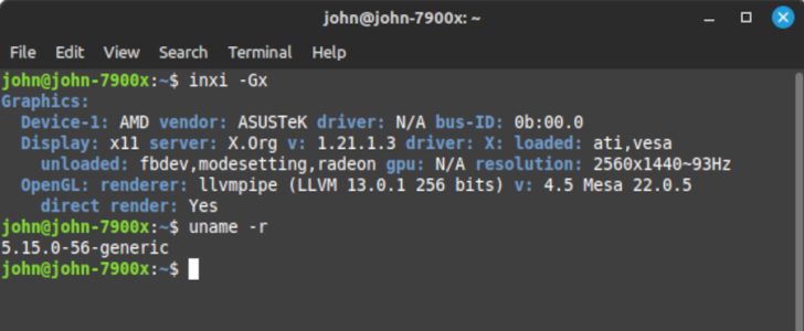

Linux Mint does not have drivers for Radeon Graphics yet. So, there is no video hardware acceleration. Things like YouTube work, but I've had 2 Firefox tabs crash. After going through Windows install with both 10 and 11 multiple times yesterday, then installing Linux Mint I'm really impressed at how some things just work better on Linux. With Linux you boot into it from USB drive, then it sees that you have WiFi and wants to connect. I press WPS button and instantly I'm connected with no need to type in password. You can run it like that to check it out, then you click an icon to do the install.

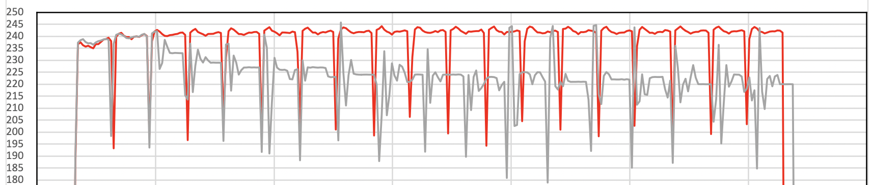

Before heading out yesterday morning I read a review on PCWorld for the 7900x and they made a big deal about the TDP being really high. I was concerned that the 240MM AIO would not be enough to cool it properly. I actually asked a manager at MC about taking the 7700x from another combo, he said that couldn't be done. On my 1.5 hour ride home I remembered that ECO mode can drastically reduce the heat and not make that much difference in performance. So, that relieved my angst. As you can see from the picture below, I'm doing my setup with a Noctua air cooler and no issues.
Yeah, Linux WiFi support has improved a lot. Tested the Clear Linux USB boot on a Dell Latitude 3420 and everything worked nicely. Couldn't believe that I was browsing the internet in less than 5 minutes after boot. Excellent way to use as a secure browsing OS where you want to do something critical, like access your online banking portal etc., without worrying about any malware left behind and embedded deep within the OS, from your previous browsing adventures.
If Linux Mint is already installed to your SATA SSD, why not install the Radeon Graphics package from AMD and test out that functionality?
Regarding M.2 SSD not working, maybe you should update to the latest BIOS version and try again? Or install it in some other NVMe slot.
I am no Linux expert. How would I install those drivers? When I go into the driver manager, it does not show that any are needed or available.

Did you try doing a secure erase on the m.2? I wonder if there was some leftover partition or something that was hindering a new Windows install. Anyway, if you ordered a new one, that is just as well with good PCIe gen4 drives being so cheap even. Good luck.
My budget box doesn't have a Samsung SSD. So, I had install Magician on it and connected the M.2 using a USB enclosure. Magician sees the drive, but says it can't secure erase it. I forgot the exact wording. Bottom line is that it was a FAIL. I'll try again when I get the new system working on the new SSD.
