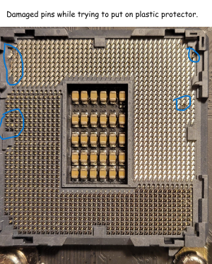

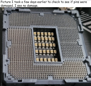

I got a new case and was moving stuff parts to it. In the process my motherboard (Asus ROG Strix Z490-A) went into a loop that it was starting recovery process, which never loaded. I thought I messed up my M.2 drive. I did a lot of troubleshooting. Finally the red CPU status light would come on when staring to POST. So, I thought the CPU might be bad. I tried another one with the same results. I realized this morning that the board was under warranty, so I contacted ASUS and they issued an RMA. (YAY!)
In the process of getting the board ready to ship, I took out the cpu and was putting in the plastic deal that is for protecting the socket. Well, I bent some pins in the process. :eek::coldsweat: So, even if the board had been bad, now I was going to have to pay since I damaged it. Has anyone dealt with ASUS and have any idea about cost? It might just be cheaper to buy another boards. Here are pics of the pins before and after the damage.
Any suggestions appreciated!

What Igor said. Personally, I would try... because honestly, at this point you can't really make it meaningfully worse — even if you mess up trying to straighten the pins, you're not any worse off than you are now. So, might as well at least attempt to make things passably better.
Crazy idea that may or may not be totally stupid

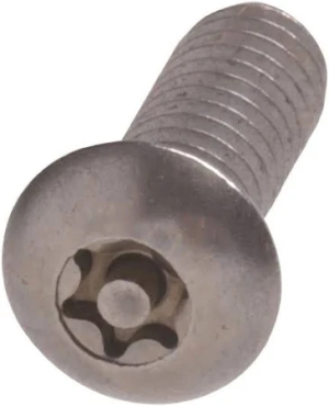

If you happen to have access to a set of security Torx bits/drivers (the ones with a little hole in the center of the bit, used for removing these bastards):
...then the very, very smallest of them might be of some use in slipping over the bent pin to use as a lever, once you've pried it up a bit with that tiny flathead Igor recommended.
The set would have to go really small, though; I think T6 is the smallest size that can actually accommodate the center-bore for security heads, and even that may be way too big for you to go poking around in your pin grid with it.

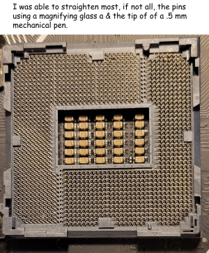

You MIGHT be able to straighten them with a magnifying glass and something really small, like a tiny flathead screwdriver.
After I made this post, I watched a few YT videos and gave it a shot. Since it didn't work before I messed it up, I don't think I should try installing the CPU again.
I was really surprised at how easily the pin moved!!Socket after working on the pins.png John

Oh, nice!
Yeah, that's why it's so easy to f--- them up in the first place. You really don't even have to be doing anything very wrong, just fail to be suuuuper-careful for a millisecond and get unlucky.

I used a better camera to take a pic and there is still some noticeable bent pins that I can't adjust. So, I'll wait for their reply and decide what to do.
