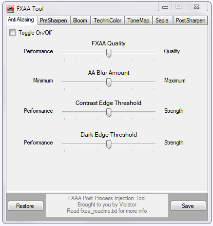

Woah, AAA (analytic AA / Adaptive AA) with 8x in-game (assuming this is multi sample) and FXAA??? There shouldn't be any jaggies left! haha. But if there are still on like alpha blends, transparent textures, or areas where bloom or HBAO prevent post AA from working right, SGSSAA would still be awesome visually. I think a 1.4ghz 7970 could hand sgssaa if it works for skyrim.
FXAA is highly customizable via its own tool. SMAA is supposed to be even higher quality, although I havent used it yet.
