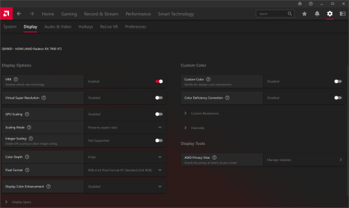

Whenever I have display connection problems, I start disabling VRR and reducing the color depth to 8 bits, and then trying to set the desired refresh rate. Open Adrenaline, click the cog on the top right, then click Display, and then choose the C2 display in the dropdown.
On a side note, make sure that the selected Pixel Format is "RGB 4:4:4 Pixel Format PC Standard (Full RGB)", otherwise the colors will look squashed.
