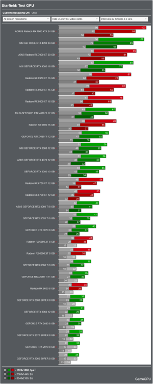

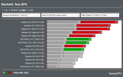

And don't get me started on starfield.
Look at these old 8GB cards performance. (from www.gamegpu.tech)
Wow, they are NOTHING alike. Who'd have thunk it? :rolleyes:
30fps lock on the XBOXes, with more than 8GBs vram tho. See how much it helped them...
And boy look at that 6GB 5600Xt go. xD
edit
Let's see the higher grade cards, while we are at it.
The slowest 8GB card is at 25fps at 1080p and the 4060ti, which is incidentaly the fastest 8GB card is at 49fps, double the performance. And the 4060ti is faster than the 11GB 2080ti too, no help from the vram here.
Aside from the game liking AMD cards more, I don't see the vram being relevant here. After Baldur's Gate 3, we have another hyper AAA game, that doesn't care about vram, hmmmm

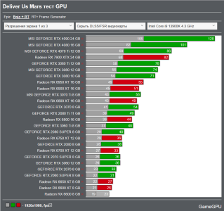

No quick, lets pay attention to Deliver us Mars at 1440p with maxed RT to show how 8GBs are bad. fml

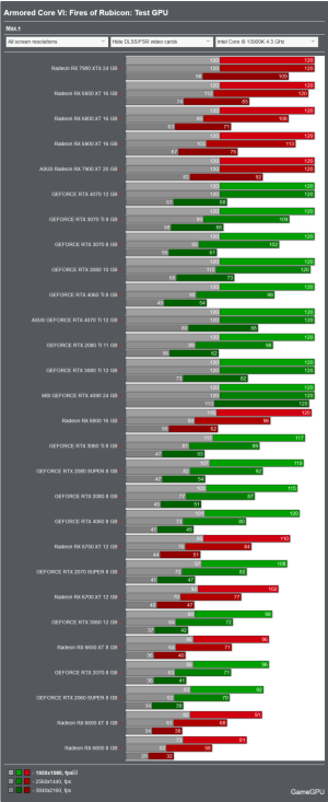

And a couple more examples, from my side. I can defend my opinion in this thread, with examples, like you do, right?
Here is Armored Core 6, on the 4070ti 4k maxed. Pretty fun game, runs very well and noone makes a peep in this thead, as is the case with countless other games that are OK with 8GB. Less than 8GB vram used.
And here are gamegpu's findings. Not a problem with 8GB cards, whatsoever.

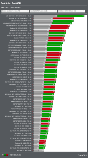

And if you want to cry a little, let's see another UE5 game I tested recently. Fort Solis. zomfg.
Screenshots from 4070ti 4k/balanced/high, which is the highest preset. Dlss balanced means even lower than 1440p.
Video ram usage is at ~7GBs and the game has drops to the 30s. And you guys are worried about the 8GBs? xD UE5 is coming and all gpus will cry regardless.
