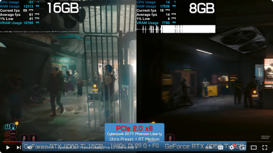

I'm shocked at these results, just shocked. Its like crazy that bandwidth can limit performance or that vram can compensate for that. Who knew that buying a $400 gpu with 128bit memory bus, 8GB vram and a 8x pci-e bandwidth could be well, over priced.
Also, just look at that frame time:
28,174
19,219
I can almost predict what the dude will say:
PCIe 2.0? Are you insane???? Who runs PCIe 2.0 in real life? And that too at x8!!???!!
Verdict: This is a very convoluted, special case that has no connection with real world gaming and thus, it's an invalid case and absolutely has no basis in reality for proving the hypothesis that 8GB VRAM isn't enough.
:p
:p
Indeed and if one looks at specs in a signature, well that 2500k that has been tested uses a p67 mobo that is pci-e 2.0. My old asrock p67 extereme mobo was anyway.

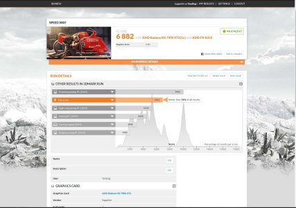

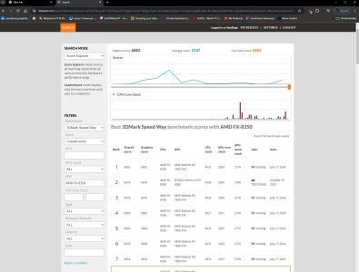

Sorry I just have to, because I was able to take #1 from a 4080S
