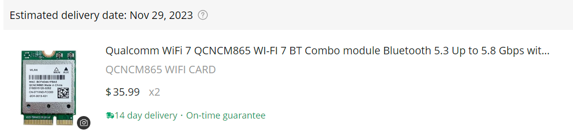

https://www.aliexpress.us/item/3256805957376726.html - picked them up for $36/ea
Got the cards and tackled the laptop install first since it's easier to mess with while not interrupting the server / router to install the M2.

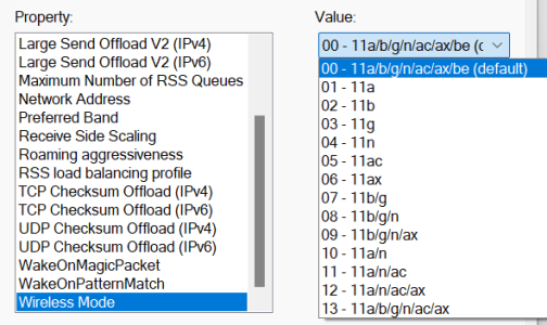

The cards show up in Windows as wcn7851 which isn't quite the same as what is named for the M2 as QCNCM865 posted all over the net for the QCA BE adapters. When looking at Google it seems as though the drivers are picking up the BGA type chip w/o the PCB? It's weird... Anyway, also if you don't have a wired connection you won't have wifi with any generic Windows drivers as this isn't picked up yet.
Drivers for download. I use a program though that picked them up when connected to Ethernet and running a scan.

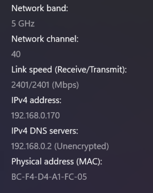

As you can see below BE is indeed on this adapter as advertised. Windows is showing connectivity to the AP I have at 2.4gbps.
Now, the next step is to finagle this M2 into my server setup which I already dread a bit because of the stuff I need to pull out to get to the M2 socket to put this into. But, it is what it is and just need to do it to get things setup and test for 5gbps wifi ability between the two using hostapd.
File copy as is right now hitting 125MB/s which is consistent with the prior AX411 card though the QCA seems to sustain the speeds better so far. Just initial function testing right now to make sure things are working. Need some time to do in depth testing / stability.

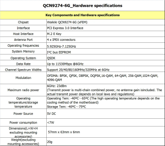

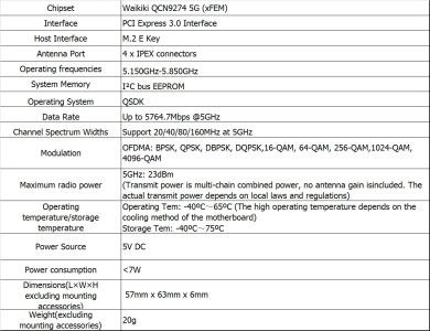

QCN9274 supports both AP and station; WCN7850 supports only station mode. Monitor mode is not (yet) supported. Only PCI bus devices are supported.
Seems as though there's a gotcha that was a bit unknown before purchase due to not disclosing the chipset. Then again Linux descriptions of devices in outputs sometimes aren't quite right either. I'm not 100% convinced this an issue as the Windows side is working but, still digging for more info on the Linux side due to the ath12k sort of working but not working as a client / ap at this point.
