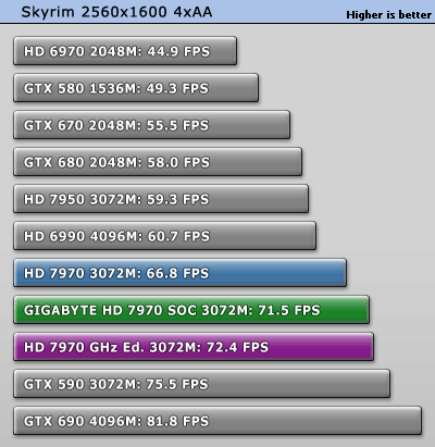

So, according to this: http://www.anandtech.com/bench/Product/550?vs=508&i=459.457
the 7970 doesnt have much on the 7950 for Skyrim specifically (I realize the difference is a lot wider for other games) at comparable resolutions, OC not with standing. Along with selling my old card, this would be a fairly economical upgrade, and make me happier until single card solutions that can comfortably push this rez come along, unless theres something I'm not considering?

Nope, i don't think you're "missing" anything.
If i was buying today, i'd easily grab a 7950 over a 7970 and overclock it. :biggrin:
I'd Look at RussianSensation's recent posts on 7950's to figure which 7950 to buy for overclocking.
He's been following them pretty close lately, so i'd trust his brand recommendations.

I would go for a single card..the performance you get once overclocked from a 7950/7970 will be roughly equal to dual 6950s.
I can't vouch for all 7950s but the MSI twin frozr models clocks really well. I have mine at 1100mhz at stock voltage, and someone else on this board had similar luck.

Sapphire Dual-X / Dual-Fan HD7950 and PowerColor PCS+ are the quietest.
MSI TwinFrozr 7950 on HD7970 PCB with 6+8-pin power connector is a great overclocker.
Can't go wrong with any of those.
Here is Review 1, Review 2.
The reason I recommended the 7950 TwinFrozr is because it was the cheapest + great overclocker. However, it's not necessarily better than something like the Sapphire Dual-X 950mhz 7950.
Still, I just checked Amazon, Newegg and Superbiiz and prices have crept back up to the $340-350 level.
The only 7950s to stay away from completely are XFX and reference models.

Xbitlabs recently tested 670/680/7970 GE at 2560x1440 with AA -- Performance Chart:
GTX670 = 48.1 fps
GTX680 = 53.7 fps
GTX670 AMP! = 55.5 fps
HD7970 GE (1050mhz) = 59.4 fps --> but most GE cards can overclock to 1150-1200mhz and that review was done on 12.6 Beta, not 12.7 Betas. :)
GTX670 SLI = 96.4 fps
Here is another review by Computerbase:
At 2560x1600 4AA, 7970 GE is 20% faster than the 670 and if you crank 8AA, that grows to 30% (although for most games that'll be totally unplayable so this 30% is more like 20 vs. 26 fps).
Here is TechReport's summary at 2560x1600:
