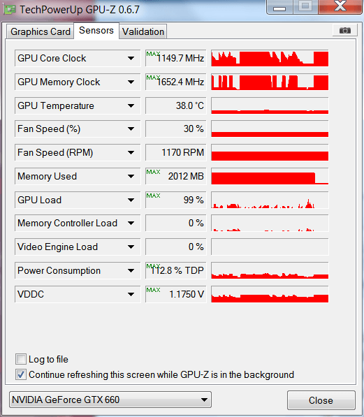

Every tab loads into video memory instead of system memory, and you can easily see it in GPU-Z (or inevitable crash ^^) Great way (albeit buggy and inefficient) to free up system memory. I torture my 7950's 3GB that way. It's also excellent stability testing for overclock because even if cores are not stressed it will catch errors.
Using OCCT GPU test with error checking option and amount of memory to use.

I got this gtx660 non ti 2gb,it won't push past 1.5gb for nothing in 2015's GTA V even at 1440p with the Very High Texture settings and the game claims i should be using 1991mb with my settings.Performance is fine usually outside of when vram hits slightly over 1.5gb when performance gets erratic....

Dropping Textures from Very High to Normal somehow makes the game feel even smoother while vram usage caps out at 1550-1564mb.There is a graphics glitch usually before the erratic performance that has disappeared as well.
