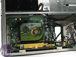

what model 6600gt is it
mine and most i've seen look sorta like that. the heatsink under the face plate is best exposed by removing it. the included weedy little fan just does a poor job forcing air through the already small heatsink. better to use your own big fan right side or blowing down across, either is better than the original solution. the original solution is just what they had to do for a 1 card slot cheapo solution.

It does look just like the one in the picture above, it's from EVGA.
