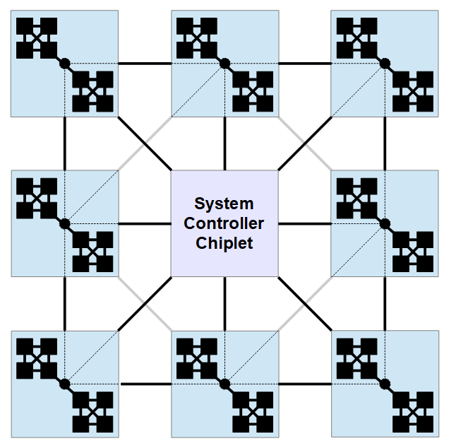

64 core EPYC Rome (Zen2)Architecture Overview?
kokhua
Sep 27, 2018
86
47
You just cant add more cores to a socket willy nilly anyway, you need to have both the pins to deliver power to it and the power delivery already in the motherboard design. I don't need to draw a diagram, if AMD wanted to increase packaging complexity and deploy a new socket they could package more in chip dies using the existing ratio's. new DDR and PCI-E standard will keep providing more bandwidth per pin allowing each die to continue increasing core counts.
AMD has publicly said that ROME will be socket-compatible to NAPLES. It is reasonable to assume that AMD planned ahead when they defined the SP3 socket. In any case, the power and pin-count issue is the same whether you are talking about 4x16C or 8x8C+1.
Currently the home agents for tracking memory requests are the memory controller the data resides on, this means any data that needs to transfer between CCX's needs to check where it is from the memory controller that data ultimately resides on, if CCX A in on die A and CCX B on die B annd memory resides on die C you can see the problem. Distributed home agents means generally that the home agent closest to the data is responsible for tracking that data.
This was the big change intel made when moving to skylake SP/EP/whatever and go look at the complex memory workload benchmark data to see the result. Except intel have a home agent per Core which is actually a massive amount of logic, AMD could do one per CCX.
Thanks for the explanation. My hypothetical architecture is UMA, Home Agents are not even needed, correct?
It all comes down to cost, remember you have the built and entire SKU stack, whats your costs look like on a salvage 4 or 6 core part.
Of course. Here, my hypothetical architecture is even more flexible. You can configure various SKUs in 2 ways:
(a) Use fewer CPU dies. For example, 64C would be 8+1 and 32C SKU would be 4+1.
(b) Use salvaged dies. For example, 64C would be 8+1 fully good dies and 32C would still be 8+1 but the each of the 8 CPU dies would have 4 non-functioning or fused off cores.
Given the tiny die size of the CPU, I suspect yields will be very high and (a) will be the preferred option. Either way, I don't see a cost disadvantage vs 4x16C. As an aside, note that option (a) applied to Threadripper is even more advantageous. Now you can configure a 16C TR3 with just 2+1 dies and you still get 4ch memory and the full 128 PCIe. You can even get the full 8ch memory if AMD decides to support it in future. And there are none of the NUMA problems associated with TR2.
I've read it, doesn't change my point, your making things cost more power and more latency all memory requests get an extra hop in each direction. If you can make it go faster (architectural design around memory access) you can do the same thing with out the uncore die and be even faster again.
Worse case performance is always a cache miss/dirty line and reread from memory, you just increased access latency.
I understand and acknowledge that the biggest disadvantage of this architecture is the increased round-trip latency arising from the "dis-integration" of the CCX from the memory controller. The additional latency comes from the CPU-to-System Controller link and the router ("Cache Coherent Network" in the diagram). But there are things you can do to mitigate this:
(a) As I explained earlier, the latency of the CPU-SC link can be made very low; for example by using a fast and wide parallel link, avoiding the latency of a SERDES altogether. Effectively, these are just "wires". Since these "wires" are very short (~2-3mm), direct and located at the die edges, we can use very low power drivers together with low voltage swing to reduce power consumption. Of course a parallel interface means a lot of signals. How many? Assuming each core needs 2.5GB/s bandwidth, the CPU-SC link would have to be capable of at least 20GB/s. If each wire is 4Gbps single-ended (~DDR5 rates), then we need 40 signals at a minimum. Let's say we need 60; that would be something like 3 rows of 20 C4 bumps along the edge of the dies. I don't think it is impossible. We can probably use ordinary MCM packaging, without resorting to silicon interposers. Of course, if AMD has something equivalent to EMIB, that's even better. What is the added latency in this case? Maybe a couple of ns, I don't know for sure. But certainly not a showstopper.
(b) Move to an 8-core CCX and double the shared L3 cache to 32MB. This should reduce the memory traffic meaningfully. I estimated the CPU die size will increase by roughy 35% from 48mm^2 to 64mm^2, which is roughly what I depicted in the diagram.
(c) As for the "router", I am not sure how much latency that adds. I'm out of my depth here. But this is not something new. Ampere's just released ARM Server Processor sports a very similar architecture, except it's monolithic (https://amperecomputing.com/wp-content/uploads/2018/02/ampere-product-brief.pdf). AMD certainly does not lack expertise in this.
(d) Finally, grouping all the 8 memory channels together gives you a lot of flexibility in optimizing memory controller architecture. I'm sure there are plenty of tricks you can use to hide/overlap DRAM latency. And the very high bandwidth will certainly improve utilization efficiency given the bursty nature of memory access patterns.
To summarize, I don't think the performance will be any worse than the 4x16C configuration. I suspect (speculate) that moving away from NUMA alone will provide a nice uplift.
Its not wishfull its just generally not worth it otherwise we would be seeing dirt cheap 45/32nm SOI edram caches packaged with lots of CPU's but we dont
I don't know why we are not seeing many designs with L4 cache but I certainly can't conclude that it is not worth it. Could it be because you can't add a meaningfully large L4 cache on a monolithic die? I imagine you would need something on the order of 8MB/core to get meaningful benefits. I do know of one example system that uses L4 cache: IBM z14. I presume it is quite successful.
yeah i dont see it. AMD think they can address 80% of the market with naples, they will be able to address even more with a 64 core 256mb L3 , improved inter CCX latency SKU. How much more of the market does your design on up and at what cost?
Below is what I wrote for the advantages my architecture offers:
"..you can configure various SKUs for EPYC and TR by using more or fewer CPU dies as necessary. No artificial de-featuring or need for salvaging dies. None of the core/cache ratio, memory channels and I/O availability concerns. None of the duplicated blocks wasting die area like NAPLES needed. Very simple “wiring” at the package level. Also, none of the NUMA issues that caused NAPLES to underperform Xeon in some workloads. Supports 2P and 4P configurations with only 1 hop from any requester to any responder compared with 2P only for NAPLES and 2 hops.
I especially like the idea of a large L4 cache (or L3, if you remove that from the CCX and enlarge the L1/L2 instead). It would be very beneficial for many server workloads. Of course, that is just my wishful thinking. After estimating the die size, I concluded that it would not be possible to add an L4 cache of meaningful size. But who knows, if they decide to move the SC to 7nm as well in Milan...."
They relate mainly to cost and flexibility. I've done some very crude cost estimates of both 4x16C and 8x8C+1 configurations, the manufacturing costs are very similar, around $200. I did not claim that my architecture is better than a scaled NAPLES architecture or will address a larger market. To me both 8x8C+1 and 4x16C are fine and will put AMD in a good competitive position vs Intel.
Let me be clear once again: my diagram simply reflects my belief that ROME will be 9 dies. If you have reason not to believe the 9-die rumor, then stick with 4x16C or whatever. If you also believe that ROME will be 9-die, or at least think it is possible, but my diagram is nonsense, then I'd like to learn why you think that.[/QUOTE]

Okay, time for a reality check.
Let's lay down a base context first:
* AMD's R&D budget has been constrained a lot in past 10 years
* AMD started working on znver2 probably in 2013 or 2014
* Naples was the first iteration of the Zen server line - its roots are back to 10h Magny Cours
* Naples use Zeppelin die which is reused in client Ryzen and Threadripper; Zeppelin CCX is reused in Raven APU
* back in summer 2017 there was no Rome but a Starship instead - 48c/96t znver2
* later in 2017 the reliable Canard PC specified "EPYC 2" as 64c, 256MB L3 (4MB per core), PCIe4
* nowadays Charlie@SA has been happy with current Rome config, AMD is confident, etc.
So Rome seems to be a 64c chip or a bit less likely a 48c one.
Now, let's introduce the current "rumor mill" favorite plan aka chiplets. According to a youtuber, the Rome top SKU consists of 9 chips - 1 IO and 8 compute. Details are sparse, but it seems the IO chip would be manufactured at an older process than the compute ones. This idea was further detailed in the diagram posted by OP.
== Naples scaled ==
* double L3 per core - Keep the traffic levels down.
* 8 cores in a CCX - The core interconnect can't probably be a Nehalemish xbar but for instance a SandyBridge's ring bus or whatever. It adds complexity (as in Sandy in 2011) and requires a special CCX for APUs.
* 2 CCXs on a die - This opens up possibilities for a nice TR and scaled down Ryzens. At the same time it keeps the level of complexity down - identical CCXs. Uniform intercore latency for ubiquitous 8c is a nice bonus.
* 4 dies on a package - Simply keep the socket, NUMA mapping, etc. the same.
=> Major investments are: new CCX for APUs, redone intra CCX interconnect and cutting-down Ryzens.
== The chiplets ==
* 8 cores in a CCX - The same issues as above. 8c intercore latency also the same.
* New type of "low latency" interconnect - low latency, a super-high power efficiency (all traffic past L3 goes out of the chip, back to the IO chip, then to RAM) => R&D
* The IO ccMaster - dealing with traffic from all 64c at low latency => R&D
* L4 - R&D
* IO chip itself - can it be reused for ordinary Ryzens - 1x IO + 1x compute? Wasting server-grade IO and L4 for desktop? A different die?
=> Major investments: ???
Now, it's time to lay the Occam's razor. The chiplet solution vs an ordinary one.
Does it make sense to throw away the Magny-Naples know-how given the budget? Mind you, this was really a decision made back in ~2014 (the times when Kaveri struggled with its crippled fw).
Does it make sense to reject znver1 and go to a super radical design which nobody has ever tried in x86 world with an evolution arch revision (znver2)?
Are you sure you can justify the power when going in/out to NB all the time? The same for minimal latency. Can you scale the IO ccMaster, etc.?
Are the benefits worth it? UMA, yields, etc.
I am going to quote my summary of your post and respond to each point. It's easier for me that way:
1. Stick to the current 4-dies architecture, each die a standalone CPU reuseable for Ryzen.
Sure, if you don't believe in the 9-die rumor. No problem at all, its a good and low risk way and will still be very competitive against what Intel has to offer in the relevant timeframe.
2. Move from a 4-core CCX to 8-core CCX, changing the intra-CCX core interconnect to a ring or mesh topology.
3. Double the per-core L3 cache from 2MB to 4MB
I agree. In my diagram, I depicted an 8-core CCX too. While I didn't mentioned it explicitly, I had factored in a doubling of L3 cache size to 4MB/core, 32MB total. It is reflected in my die size estimate of 64mm^2. I think this will meaningfully reduce the memory traffic and help mitigate against any increased latency arising from the dis-integration of the CCX and memory controllers.
1. R&D needed for a new type of low latency interconect for the CPU-to-System Controler link
This could be as simple as "wires", or a parallel version of IF, without the SERDES stage. Please see post #176, pg. 8 for a more complete explanation.
2. R&D needed for "ccMaster" to deal with traffic from 64C at low latency
Again, this is not black magic or anything new. Ampere's just released ARM Server Processor sports a very similar architecture, except it's monolithic (https://amperecomputing.com/wp-content/uploads/2018/02/ampere-product-brief.pdf). AMD certainly does not lack expertise in this.
3. R&D needed for L4 cache
I estimated the die size of the SC and concluded that it's not possible to add a meaningfully large eDRAM cache (~8MB/core), so this is not going to happen. But if the SC die migrates to 7nm in MILAN, then anything is possible.
4. System Controller chip cannot be reused for Ryzen efficiently.
Repeating what works is not the only way to achieve R&D cost efficiency. This is what I will do for 2019 product line-up if I were AMD:
Datacenter: EPYC 2
Architecture: 1~8 CPU dies + 1 SC die for 8C /16C / 24C / 32C / 40C / 48C / 56C / 64C SKU's.
Against Intel Xeons: clear win
Workstation: ThreadRipper 3
Architecture: 2/4 CPU dies + 1 SC die for 16C / 32C SKUs (same as EPYC 2 but artificially limit to 4ch DDR4 and 32C max)
Against Intel Core X series: clear win, 16/32C with 4 memory channels and none of TR2's trade-offs
Mainstream Desktop and Notebooks: Ryzen APU
Architecture: monolithic 8C/16T Zen2 with beefy GPU, fuse off features for power and product segmentation
Against Intel i3/i5/i7/i9: equal on CPU, beat on graphics
All the above with just 3 unique die designs. We can add another smaller 4C/8T APU later if volume justifies.

kokhua
Sep 27, 2018
86
47
I don't think anyone has spotted that.
Canard PC has some time ago posted a TT about AMD eng Sample with 64 cores/128 threads and 256 MB L3 cache. If that is the case, and we are talking about 8 die config it may mean that each die has 32 MB of L3 cache, unless the 9th die has 128 MB of cache.
This seems to fit right in with my diagram. 32MB L3$ per CPU die = 256MB per processor. Do you have a link to share?
AtenRa
Feb 2, 2009
14,003
3,362
Not really. In this architecture, you can use just 1 CPU die + 1 SC die for the 8C/16T SKU and still have the full 8 memory channels and 128 PCIe. And it would be very cheap to make: <$100.
Removing the IMC from the CPU die and installing it to a secondary chip that communicates through IF will increase latency to the moon perhaps even Jupiter, it will have a tremendous negative effect in performance. Not to mention you will need to create another die with IMC to use for the Desktop SKU.

kokhua
Sep 27, 2018
86
47
Already discussed at length. Please read the whole thread.

For my purpose, I am perfectly happy to treat [topology] as a black box and let the experts worry about the details.
Ok. Thanks for the feedback and for clarifying that you (like the ARM leaflet you linked) do not imply much about topology in your block diagram. Here is my take on how the topology may look, should the 9-chiplet rumour be true, and assuming that AMD will stick with the 4-core CCX as a reusable IP block.
The black boxes are CPUs arranged in a 4-core CCX with shared L3 as before. The blue boxes are 8-core CPU chiplets. The lines are Infinity Fabric interconnections forming the network-on-chip (presumably implemented on silicon interposer). And the circles are routers (crossbars) within the chiplets. Note that the grey interconnections may be omitted, in which case each CPU chiplet requires only 3 ports (otherwise 5, of which two go unused at the corners).
PeterScott
Jul 7, 2017
2,605
1,540
I think if you go with a central chipset to connect to all the dies, you are probably going to forgo interconnects between the individual cpu dies and handle it all through the central chipset.
No matter how it is accomplished, moving to 64 cores will increase connectivity complexity, whether it is buried inside the CPU chip dies, Controller chip, or package interconnects, or some combination of them.
