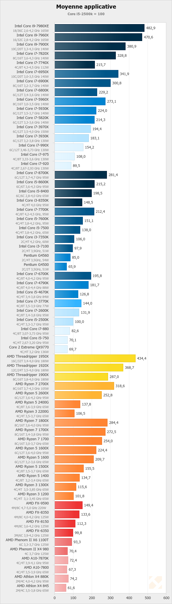

I have all the evidence I need-
Anandtech's Professional performance on Windows.
Hardware.fr graphs.
IPC comparison at 4GHz across a range of applications.
5-7% on average, without accounting for clock speeds.

It seems averaging isn't your strong point - go down and see "Moyenne applicative", 120.6/116 = 1.04. So even with this one "L4" variable thrown into the mix, which according to you would make the comparison useless, the difference is still less than 5%. Now you'll complain about 4MB L3 vs 6MB L3.
