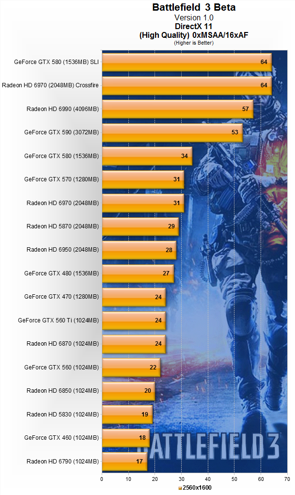

I just plopped in a single 6970, played even the BF3 beta just fine, albeit at slightly reduced settings. If I had the cash I probably woulda sprang for 2x 6950, that should crush anything. As it is, whichever route you go, make sure you get a 2GB card (or the 1.5GB 580 or 570 versions) as games are using over a gig at that res now.
How much do you care about IQ settings and what kind of games do you play ?
If you care about IQ and you plan to play recent, demanding games; you're going to need two cards. 6950 2GB CF is the best value for that resolution, 6970CF is better. 570SLI is no good unless you want to buy the 2.5GB versions @ $400 each, doesn't make much sense when a 6970 is $330AR
6970CF & 580SLI are about equal at 2560x1600 in demanding games, so decide between those two if you don't want to go for the value choice of the $480 6950 2GB CF.
6970CF is about $200 cheaper than 580SLI though.
I wouldn't trust those benchmarks. Looks like they use older drivers (just look at the Civ V and Metro 2033 benches) or something, because Nvidia is typically stronger than AMD in those two titles.
Also, the list of games is pretty small. If I were you, I'd peruse a few websites for reviews that use current drivers and more titles.

AMD cards scale better in dual-GPU. 6970 crossfire is a lot cheaper than GTX 580 SLI while performing the same. Plus you get additional VRAM, which is sure to be of use at 2560x1600 in games like Rage, BF3, even CIV5 (uses over 1GB in DX11 1080p for me). Personally I would go with 6950 crossfire and unlock and overclock them to 6970 speeds. Once they start feeling slow (probably not any time soon) I'd upgrade to 7950 crossfire, or they might last until 8000 series.

In Metro the 580s are hitting a VRAM wall, it's why 6970CF is faster at 2560x1600, more memory. AMD's cards have better texture throughput than nvidia's, it's part of why they perform so well at high resolutions.
Anand's reviews are solid. That review you linked is sort of irrelevant. It's not comparing CF to SLI, it's single card benchmarks. Crossfire scales better than SLI, which in tandem with AMD's better performance at high resolutions, tips performance for AMD. There are other benchmarks using those cards that show the same general results.
At 2560x1600, you'd be hard pressed to see any difference between a 6970CF or 580SLI setup if you couldn't see in the case. Once you get into the price point of 580 SLI, you're also in 6970 Tri-Fire territory. Heck for another $60 on top of the cost of 6970CF and $150 less than 580 SLI you can get 3 6950s for $720 which will blow the doors off 580SLI and 6970CF, and if you unlock them....
580SLI is a really poor option if you are at 2560x1600 with the current available AMD cards.
I've played through Metro 2033 twice, first on dual 480 SLi, and finally on 580 SLi, and I never ran into any VRAM wall.
The only time VRAM plays a major factor in Metro 2033, is if you're playing at resolutions above 2560x1600, or if you're turning on MSAA (MSAA is completely unnecessary at 1600p when you have analytical AA) and or DoF (DoF is a massive performance hog for a questionable IQ boost and most people always recommend turning it off..)
Overall, you have to admit that it's very rare to run into VRAM limits at 2560x1600. There are only a few exceptions where this occurs, which is why the 3GB GTX 580s aren't worth it unless you're playing at resolutions above 2560x1600..
The whole point of me posting that review was to give a more current perspective on the performance of both GPUs with up to date drivers. It's difficult to find reviews of SLi rigs that use current drivers, and drivers can make a big difference in the benchmarks.
