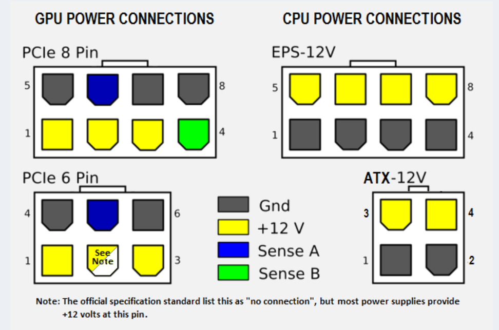

Does anyone have 2x 8"(20.32cm) 6 pin extension cables they would like to get rid of? Need them for the pair of 750ti's I just received to bump up my PPD.
Thanks,
Chris
Heya Chris, it's just a few 12v wires (yellow usually) and ground wires. You can easily splice in an extension.
It's okay to bundle the 12v's together and the grounds together, and then you can just use anything you've got lying around (heavy speaker wire, lamp cord, one of those $1.69 triple outlet extension cords, landscaping wiring, etc etc).
If your cabling is all black, yeah, I'd be nervous doing that though. But it's a fairly easy job, basic electrical hand tools, whether you solder it or just use butt splices and crimpers.
Much faster than waiting for the mail during the holiday rush anyway. Pin-out diagram included at the bottom of this post.
I hope this helpfulness offsets me passing you tonight. ;)
You don't need all those cards working anyway........... :D
Well, it IS 82F in the house right now with windows open and fans running. Perhaps you're right. ;)
Pic for Desslok. The 'sensing' wires should be connected to ground/negative:
