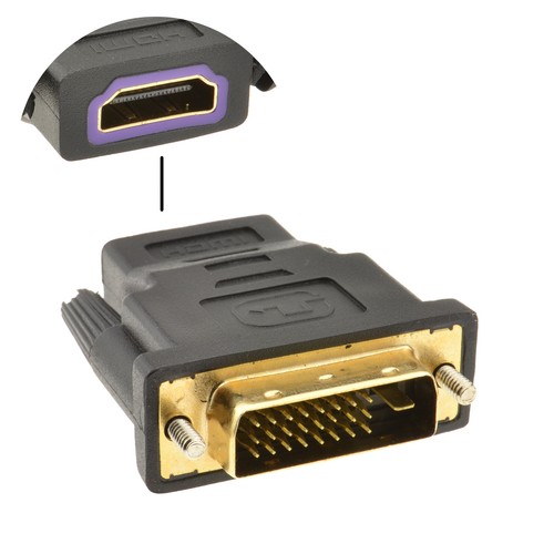

so would it be as cheap as this?
(I plug in my existing DVI-D cable, and the adapter in the video card) DVI-I Dual Link(24+5pin) Female to HDMI-compatible Male Converter Adapter HDTV D
(I buy an HMDI cable, and the adapter in the monitor) DVI-D Digital 24+1 Male to HDMI Socket Adapter Converter Joiner GOLD [005695]

After some research, I'm sure I can't get a dual DVI-D to HDMI adapter, they're all single and capped at 60 Hz. Supposedly I can spend 10 times more on a displayport to dual dvi-d, and will render at 144 Hz. A new monitor is 100 times more expensive than the adapter...
