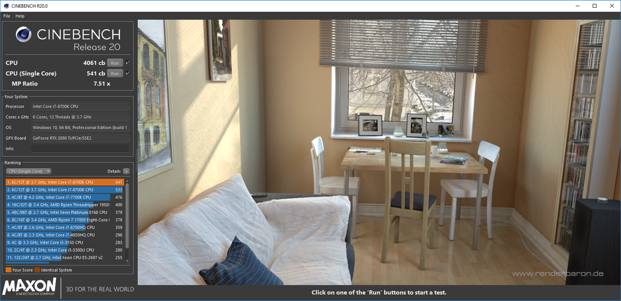

Broke the 4K mark with 5.2GHz, no AVX offset.
4061 cb
541 cb (single core)
Takes almost 1.400V to achieve a stable 5.2GHz and nearly adds as much additional power usage as it took to go from 4.7GHz --> 5.1GHz, so I'm backing down to 5.1GHz for my 24/7 overclock.
Reactions: lightmanek
