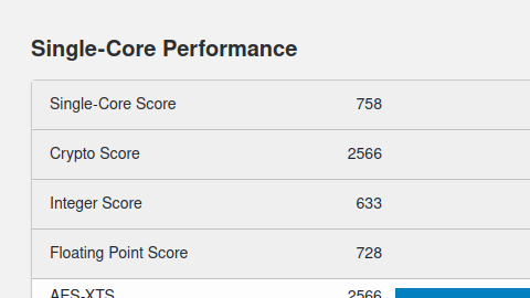

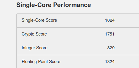

As usual, I return to see garbage analyses being posted and regurgitated for dozens of pages.
These are the two results on Geekbench 5 so far:
[1]
[2]
Now, anybody interested in what "Xen HVM domU" is could do a Google search to find out that it is the Xen hypervisor.
Here's the thing - Virtualized environments are WAY MORE unreliable when it comes to Geekbench detecting the CPU specs using the usual method of querying MSRs.
So that automatically discards the first result as it is running a hypervisor.
So that leaves result [2].

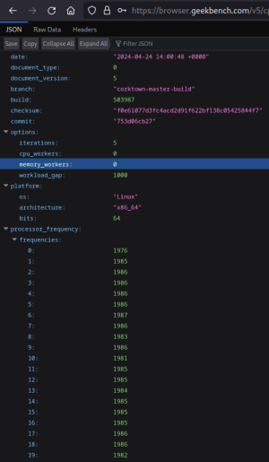

Doing the usual appending ".gb5" to the URL shows that it is running 2000 MHz frequency.
And here is my 11370H @2000 MHz fixed frequency.
N.B. It is very easy to fix a frequency in Linux - just type
Code:
cpupower frequency-set -u xxxxmhz
and
Code:
cpupower frequency-set -d xxxxmhz
as root in the terminal.
So here I am focusing on the result for my 11370H
And here is the Strix ES
So compared to Tiger Lake at 2.0 GHz - the frequency being the same as the leak - Zen 5 is ~31% faster clock-for-clock.
Intel has this covered with Lion Cove.

Any chance you could run it on the same sub-version as the Zen 5 run?

Zen 5 already confirmed worse than Zen 4.
Yeah, the 1.41 GHz result seems too good to be true (probably not reading the frequency correctly) because that would be ~2X increase. However, the 2 GHz result also seems too low to be true (probably bad result with immature platform/BIOS), otherwise it's like a <5% IPC increase gen on gen.

How? Thought this would still be a ~15-20% increase over Zen 4 still?
I’m going off of @tamz_msc ’s results and rough IPC math from Anandtech reviews.
Zen 3 over Icelake was about 15% integer IPC and ICL ~ TGL while Zen 4 is roughly 10% over Zen 3. That leaves Zen 4 being roughly 26% higher IPC than TGL while @tamz_msc showed 31% higher for Zen 5 which would mean Zen 5 would be less than a 5% IPC increase over Zen 4. It’s really rough math but close enough to show that something is off in the score.
tamz_msc
Jan 5, 2017
3,828
3,661
...and 12 percent higher IPC than Golden Cove at 2000 MHz, according to @gdansk posted score.

adroc_thurston
Jul 2, 2023
2,529
3,696
Zen 4 has slightly higher IPC than Golden Cove so the numbers track with the above calculation, roughly speaking at least. There’s basically no way Zen 5 gets that low of an increase unless AMD completely botched something. The far more plausible answer is that it’s just that the score is an ES on an immature platform that is limiting performance.
it's not 2GHz.
what are you on.
clk readouts are in .gb5. like, wat?
