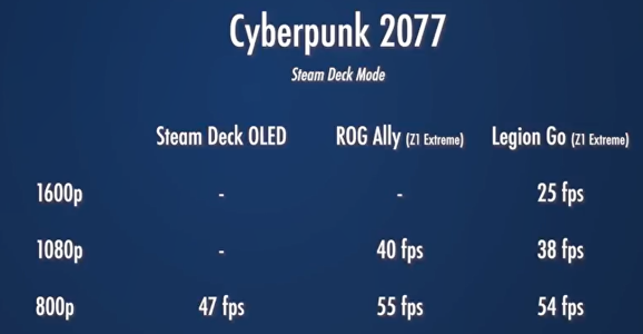

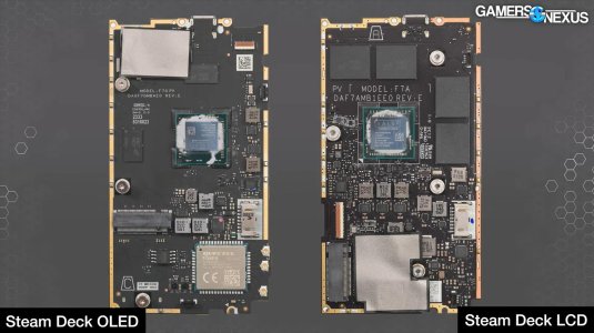

Steam Deck 2 Speculation
Above picture shown the changes of PCB of Steam Deck OLED compared to OG Steam Deck. The memory chips have been reduced to 2 pcs. Memory bus still remains the same, i.e.. 128-bit. Each memory chip is connected via 64-bit memory bus which provided 102GB/s memory bandwidth. With upcoming 64-bit LPDDR6 which provides same bandwidth, Steam Deck 2 could further reduce memory chip to one piece only. SoC also will benefit by removing half of memory connector. Therefore, combining with advanced process like N4P, Steam Deck 2 could double FP32 numbers while maintaining same battery life.
In games like Cyberpunk 2077, SD2 should provide much better fps (~30-50% ?) in 800p resolution while still providing excellent battery life:
This is what Valve wanted in next generation power upgrade SoC empowered by 64-bit LPDDR6.

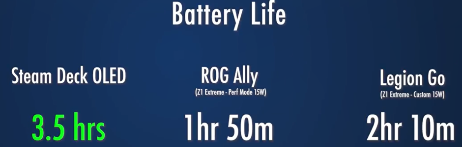

TBH, waiting for LPDDR6 to increase performance and battery life especially with AMD SoCs sounds absurd when AMD has the solution right under their noses: V-Cache or Infinity Cache!
NV has been rumored to release handheld console. It seems like NV is going to use same ARM SoC in upcoming Surface X. The SoC going to connect with 64-bit LPDDR6 which provides about 4 TF in FP32. This is the same TF as Xbox Series S, can't wait for Jensen to announce Pocket XSS in the future...:p
I doubt that Valve will go for double spec.
Remember that the Van Gogh SoC is only 2/3 the CU count of Rembrandt, which they almost certainly would have been told was in development.
To me that says they went for 8 CU for cost and/or power reasons.
So while them just jumping straight on Strix Point 16 CU or something like is possible, I wouldn't bet on it.

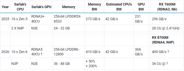

AMD's Speculation on LPDDR6 solution
Due to ever increasing memory bandwidth of LPDDR6, (Strix Point's die size is around 225mm2) AMD could switch to ARM platform in the future. It is game changer for AMD from technical AND business points of view. TLDR, please follow up in the following thread:
AMD's Future APU Gone ARM
AMD will likely be providing monolithics ARM SoC with 64-bit and 128-bit LPDDR6 support. Meanwhile, AMD will keep upgrading Sarlak's family as shown below:-
Last time, adroc said Sarlak's performance is about 7600M level. Based on memory bandwidth, yeah it is comparable. The only thing is RX7600M is build by N6 process with 28 CU @ 2.41GHz. Meanwhile, Sarlak's iGPU is having 40CU build by N3E process. Why do AMD need so many CU for RX7600M's performance?
My theory is AMD is planning to support LPDDR6 support on the same silicon. AMD could potentially bump the memory controller from 4.3 Gbps to 6.4 Gbps, then total memory bandwidth will increase to 410 GB/s.
If AMD is releasing Sarlak with LPDDR5x first, Sarlak6 will come one year later with 50% memory bandwidth improvement. In IT world, anything above 50% improvement within same interface is considered big upgrade.
However, if AMD straight away launch Sarlak with LPDDR6 support due to early availability, then we should be expecting three times bandwidth improvement.
Let's see how the thing turn out.... ;)

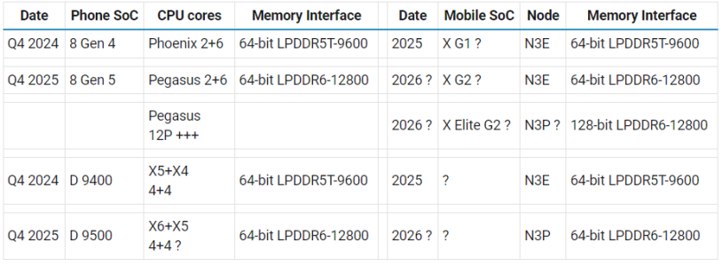

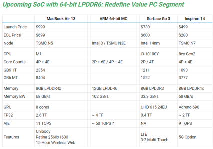

Another game changer related to LPDDR6 is Mediatek and Qualcomm's mobile phone flagship SoC will be used as notebook SoC. Due to same 64-bit LPDDR6, Mediatek and Qualcomm will likely use the same die for flagship and mobile SoC as listed above.
In fact, as reported earlier, Qualcomm might be supporting LPDDR6 in upcoming 8 Gen4; even though 8 Gen 4 supposedly be using LPDDR5T. Clearly, the memory controller on the SoC could support both memories.
In the future, we could see army of ARM SoC from Qualcomm, Mediatek, AMD and NV fighting for PC market share. It might not be directly related to LPDDR6 but Mediatek and Qualcomm are going to use it in order to spread the high BOM cost.

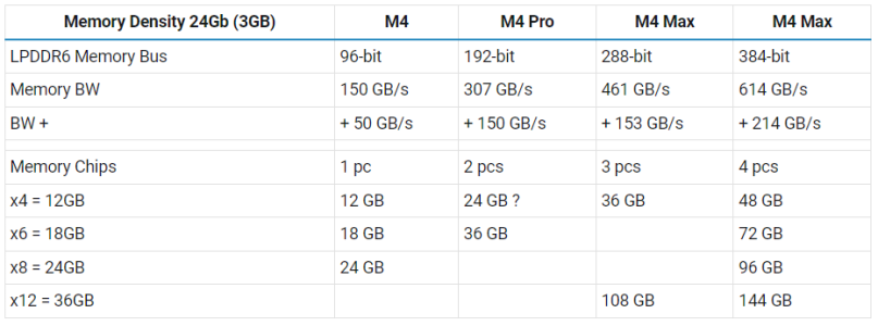

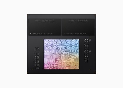

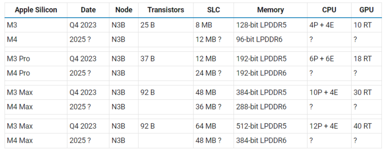

Apple's Unique LPDDR6 Solution
Shown above is the die shot of M3 SoC from Apple. Similar to SD, M3 is connected to 128-bit LPDDR5-6400 with 102GB/s bandwidth. What could Apple do to support upcoming LPDDR6? If Apple going to support 128-bit LPDDR6, the memory bandwidth will be doubled. Nah, Apple won't be so generous especially M-series is used on tablet as well. Then, it hits me that Apple's weird decision to reduce memory bus of M3 Pro from 256-bit to 192-bit bus....
Yeah, Apple going to implement something weird yet make sense if you understand the logic behind. For upcoming M4 series, Apple going to introduce 96-bit memory bus of LPDDR6 per channel as shown below:-
First of all, you have to understand Samsung, the biggest memory maker is making 24Gb (3GB) die as standard LPDDR6 die. Therefore, all the LPDDR6 memory chip will contain multiple layers of memory die, the most common one is x4 equal to 12GB. And that's the base memory size which connected to 64-bit memory bus. With 96-bit, Apple have to custom the pin connector on the memory chip to support extra 32-bit memory bus. The advantage is M4 will provide extra 50% memory bandwidth within single memory chip. Even with upcoming 64-bit LPDDR6X-16000 could only provide 128 GB/s bandwidth. Clearly, with 96-bit LPDDR6-12800, it provides Apple plenty of headroom for future generation.
And yes, Apple will keep using LPDDR6-12800 for many generations even after LPDDR6X arrive. Initially, Apple have to pay slightly more to Samsung due to custom design. With each faster LPDDR6 arrive, the current one will keep dropping price. And Apple will reap the benefits. Meanwhile, other OEMs will have to keep paying higher price each newer generation. Apple just keep selling newer generation of M-series with 12GB as standard. And that is game changer for Apple cause Apple no longer have to worry about ever increasing memory prices.
Reactions: Ghostsonplanets

Another benefit of 384-bit memory bus compared to 512-bit memory bus is reduction of SLC cache as shown below:-
SLC cache is actually associated with memory controller. With 384-bit memory bus, the amount of SLC should drop from 64MB to 48MB.
Of course that's always an open possibilty. But I am skeptical about it, especially with regards to Qualcomm doing so.
You see, these flagship 64-bit SoCs come integrated with cutting edge 5G modems. They take up about 15-20 mm² of die area.
Not all brands want to put 5G in their laptops. So the added cost of the 5g modem but it's redundancy when not used, is a waste of money. Hence why all Snapdragon 8cx chips and now the Snapdragon X Elite don't have integrated modems.
Qualcomm and Mediatek could disable 5G modem if they want. And do you think it will be cheaper for Qualcomm and Mediatek to design new SoC which support same memory bandwidth?
Plus X-Elite always has an option to add 5G modem, so Mediatek and Qualcomm with integrated modem is actually a plus ....
LPDDR6 is not coming before 2026. DDR6 is coming AFTER LPDDR6.
Strix Point Halo is coming next year, with DDR5 memory controller. Before LPDDR/DDR6 achieves 12800 MT/s it will take very long time before we see something like this on consumer products, most likely - 2028, at the earliest. So in what world would AMD implement LPDDR6 memory controller for Strix Point/Sarlak SOCs?

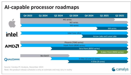

The slide from Canalys provide timeline regarding upcoming SoC launching information. As for any leaks, timing could change (Strix Point for example). I will list down some interesting tidbits below:
  • Canalys estimated that Apple will launch M4 series in Q1 next year is much more interesting cause I speculated Apple will launch MacBook with LPDDR6 as early as possible. There is news about upcoming 8 Gen 4 supporting LPDDR6 which I think is a bit too early. Anyhow, Q1 2025 seems believable cause JEDEC will approve LPDDR6 standard in Q3 this year. This gives OEMs half a year to manufacture system with LPDDR6.
  • @adroc_thurston said Sarlak is fixed, then why don't AMD launch it in Computex? Why wait until Q1 2025? As I speculated in the early thread, we see how the Sarlak go....
  • X Elite with 8 cores might not be correct naming...the thing is the launching date is same as 8 Gen4, could X without Elite be using the same SoC as 8 Gen4??? And 8 cores SoC could be 2+6 Phoenix cores?

Walmart began selling MBA13 with M1 SoC @ $699. You could view this notebook as MacBook SE. Even though the notebook was launched three years ago, the specs are still pretty impressive compared to the rest of fanless notebook and tablet. And Apple know it, that's why Apple still selling it but not through official web site. At $699, even 8+256 configuration seems OK compared to others...
Surface Go 3 has not been updated for two years plus cause Intel's low power SoC has not improved much. The thing could change when NV launch their ARM SoC in 2025..I think Microsoft will use NV SoC in their Surface Go 4 at aggressive price point ($600 - $700).
NV using Intel 3 to manufacture ARM SoC with 64-bit LPDDR6 is a very strategy move from Jensen. Compared to TSMC, I believe IFS has ample capacity to support NV if NV want to expand production. And I think Jensen has aimed much higher volume on his returning SoC. Think Switch's SoC which is made by SF and think how many millions Nintendo has shipped with Tegra SoC....hoho I want to say NV's ARM SoC going to be Black Ship moment for consumer PC market, we shall see.. :cool:
