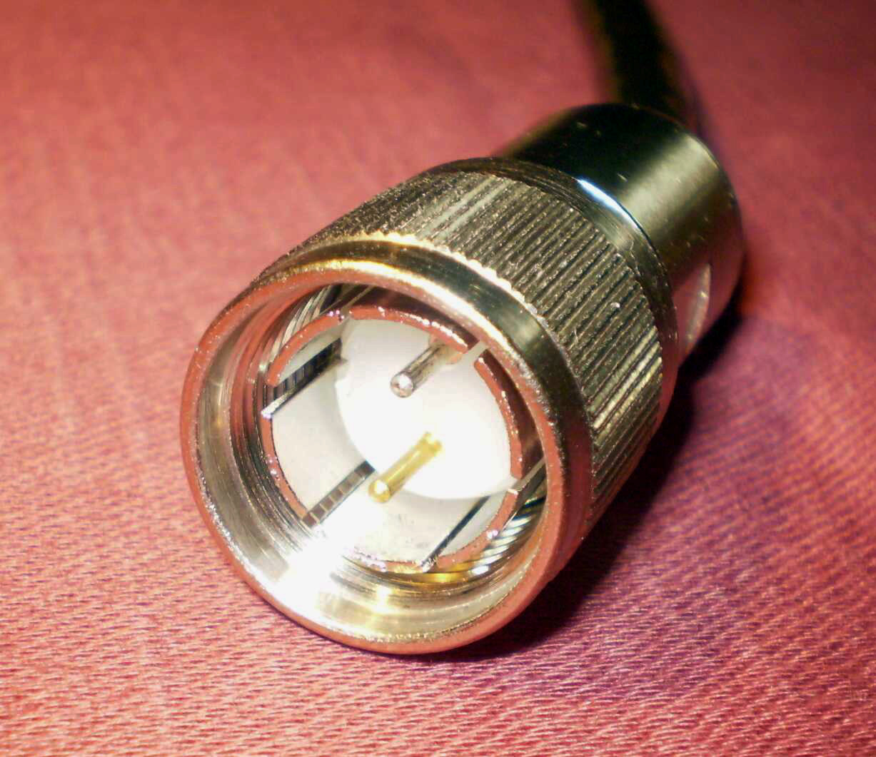

Every time I see the word 'twinax' it takes me back to the day of these cables:
