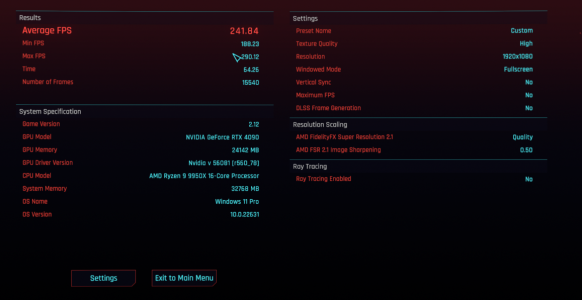

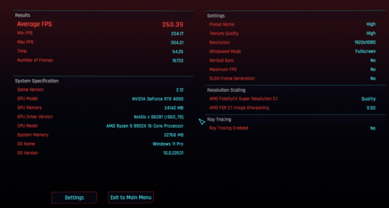

Agesa 1.2.0.2
This is with my bad 9950X
So the theory was that the high latencies were due to the second CCX being put in an aggressive sleep mode to save idle power vs Zen 4. Someone even posted examples from TPU 9950X review. Can you check idle power draws before and after?

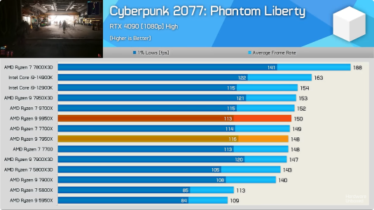

There are games (like CA engine games (Total War, Warhammer etc)) that utilize all cores, and there was a significant regression there according to the last AT tests (rip). Maybe someone can do the comparison and see if this update fixes abysmal fps in that benchmark
There are other outlets where 7950x vs 9950x score the same in Total War Warhammer III in launch day reviews.

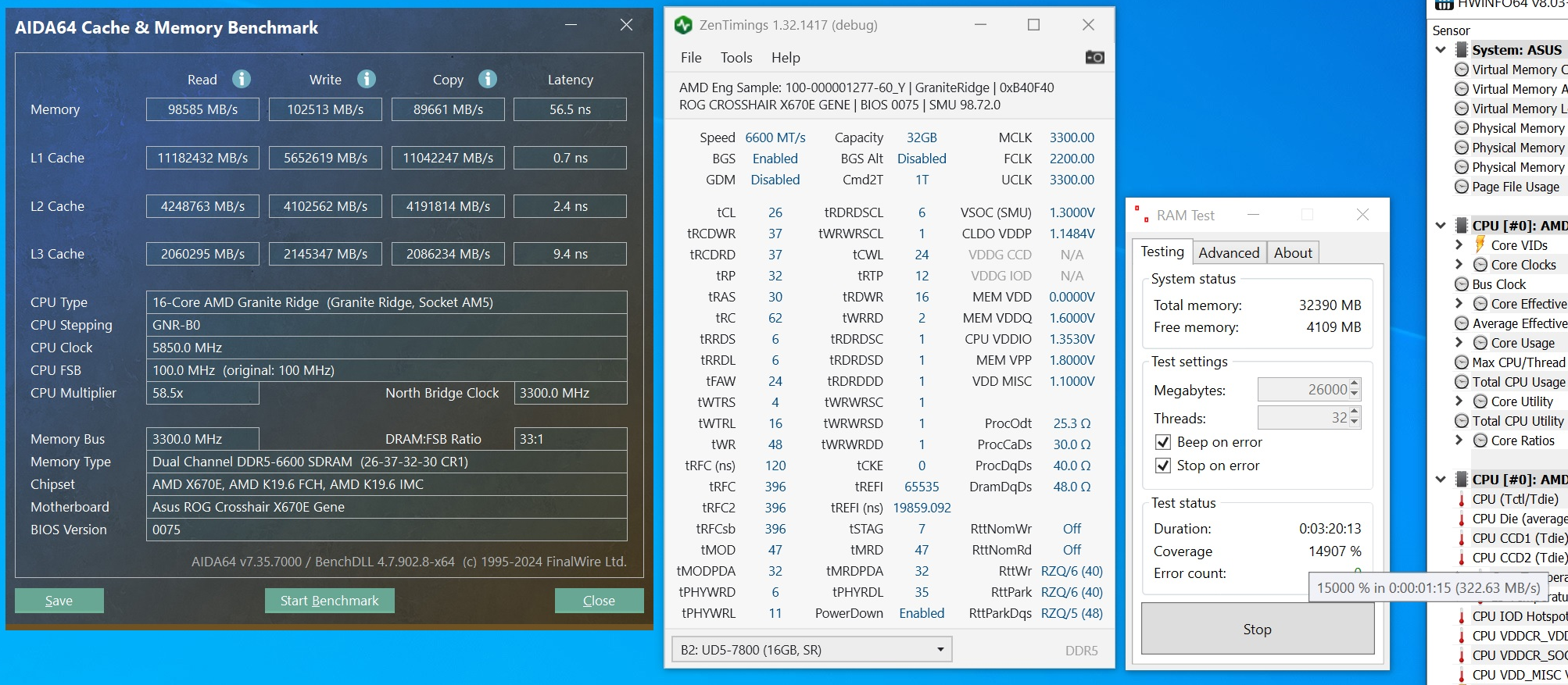

@Det0x I can't find the screenshots where you displayed the effects of interccd latency. What tool did you use ? or what post number was it that showed these ? I want to test mine. I went back several pages and could not find it.
blackangus
Aug 5, 2022
149
204
86
I think this is what you were looking for good sir!
