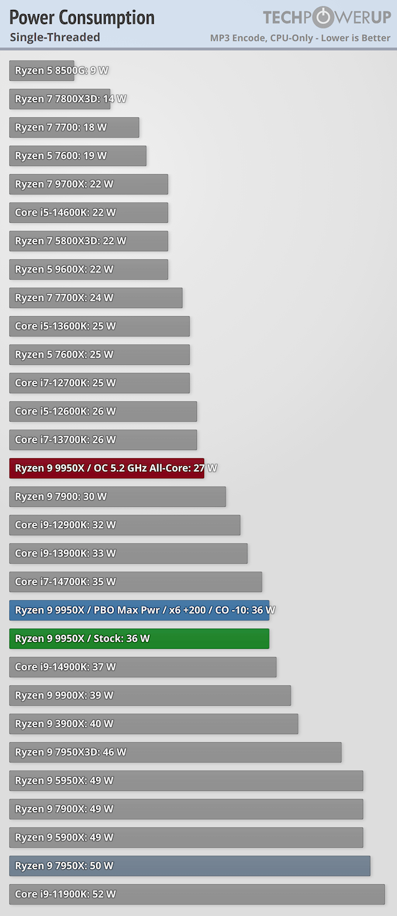

TPU tests ST power numbers. Maybe they'll do updated testing, but I doubt it. Their graph is why I figured it was a power saving feature to begin with:
All the examples I saw in this thread, when you looked closer, showed the same regression with the 7950x versus the 7700x.

So the theory was that the high latencies were due to the second CCX being put in an aggressive sleep mode to save idle power vs Zen 4. Someone even posted examples from TPU 9950X review. Can you check idle power draws before and after?
*EDIT - reviewing TPUs review, I dont see the much lower idle results that I believe were posted somewhere earlier in this thread.

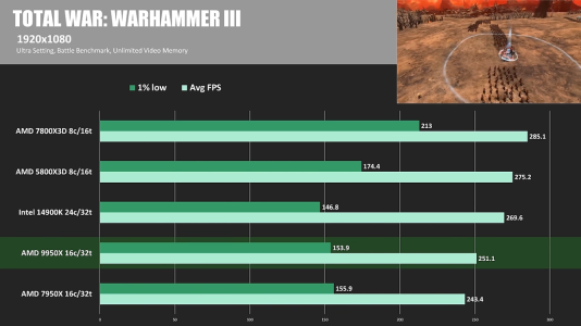

There are games (like CA engine games (Total War, Warhammer etc)) that utilize all cores, and there was a significant regression there according to the last AT tests (rip). Maybe someone can do the comparison and see if this update fixes abysmal fps in that benchmark
There are other outlets where 7950x vs 9950x score the same in Total War Warhammer III in launch day reviews.

Probably they were testing it in a 100% gpu bound scenario (aka if you don't set grass to extreme, for example)
Paul’s hardware didn’t show the issue despite it not being GPU bound.
The Anandtech Warhammer result is probably the closest data point we have that shows a potential issue, but the fact that it’s 1 data point, the 9900x is outperforming the 9950x in their test, and no one else that I’ve seen seems to see the same thing in that game, leads me to believe it’s an issue in Anandtech’s testing. Wouldn’t be the first time, they’ve had lots of issues in their reviews over the last couple of years. Unless someone directly tests for it though, we’ll never know for sure.
