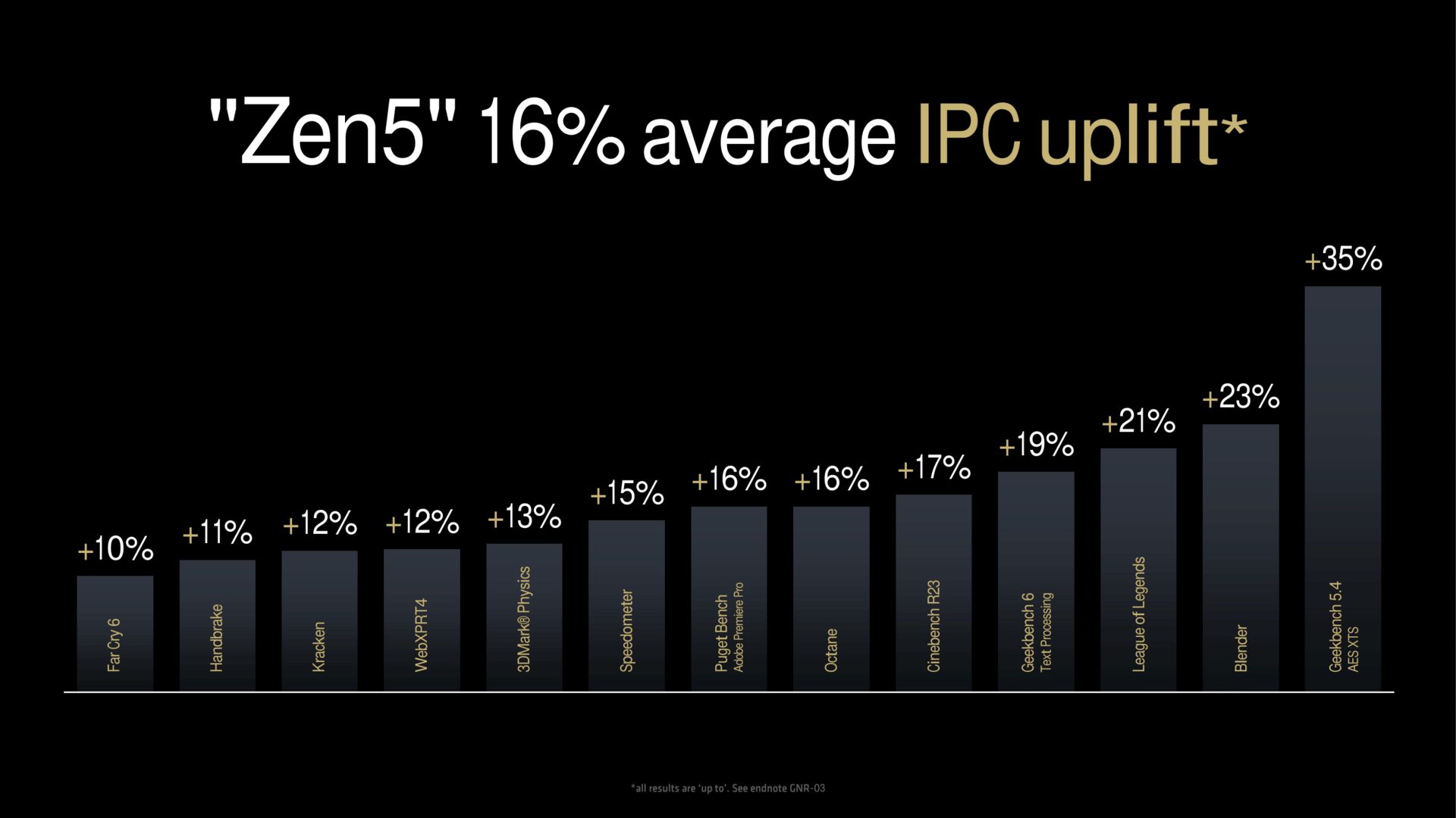

Performance is exactly what amd has advertised minus a few percent.
lol, what does that even mean? Im still saying the betting line should be ~+10% faster in gaming, SKU vs SKU, not necessarily clock for clock, vs Zen 4. I really believe the Zen 5 core is capable of more, but zero improvements in memory speed vs Zen 4 will definitely hold it back.
So, ~10% better than vanilla Zen 4, 5%-8% slower than Zen 4 X3D on average. This is a big reason why I think AMD should (and likely will) price Zen 5 more competitively at launch than Zen 4.
Goop_reformed
Sep 23, 2023
308
340
No need to guess:
From WCCF tech
