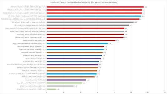

yuri69
Jul 16, 2013
535
958
if true, Apple got an avg improvement of 7% in 7 months and achieved more than AMD did in 22 months. This makes M4 look very good.
This is embarrassing. Like I think it’s fair to say AMD lost talent. I mean it looks like it. The cadence slowed down as well after Zen 3.
To me it's just good old AMD coming back. People who lived through the hype cycles of K9, Barcelona, Sandtiger, Bulldozer (and, of course, Tunnelborer), or K12 know this.
deasd
Dec 31, 2013
567
921
Who is this guy? Is he credible and in a position to know?
I’m guessing the numbers provided to OEMs were the 10-15% range we’ve seen before.
iirc he did IPC/ST test for many CPUs include Zen4 and I saved it with luck. It showed Zen4 SPECINT has only 4% uplift against Zen3 and it's still on par with Goldencove. Also bigger L3 cache/V-cache variant has higher IPC.
I'm not calling him or SPEC unreliable but at least it's either SPEC as industrial standard is very stringent, or we should be very careful when we see SPEC results no matter from thirdparty or official especially when comes to compiler concern.

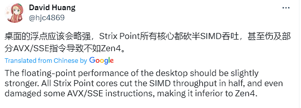

OTOH he also mention Strixpoint SIMD unit being serious cut down compared to GraniteRidge.
The floating-point performance of the desktop should be slightly stronger. All Strix Point cores cut the SIMD throughput in half, and even damaged some AVX/SSE instructions, making it inferior to Zen4.

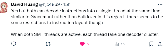

From David Huang, for Strix, seems they cut the FP a lot, including reducing AVX/SSE throughput.
So Strix indeed is 256b wide FP. The 4C CCX has half the L3 cache and the 8C CCX has 1/4 the L3 cache of DT.
Pretty hefty cuts.
And the unusual front end layout (for AMD),
It might be a decision to make it less vulnerable in SMT.
