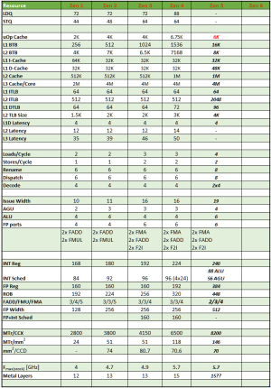

- 3 64 bits integer multipliers up from 1; that’s strange, these instructions rarely are a bottleneck (except outside of things like GMP, RSA); if this is confirmed, Zen5 might prove great for computational number theory.
I don't get it either. (I also don't get why ARM went from 2 to 4 imul's in X925.)
Profiling has shown over and over again that the vast majority of multiplies executed are by constants, which shouldn't be lowered to imul anyway. Relatively few of the ones that aren't by constants are perf-critical unless you're doing, like, integer digital signal processing.

This is absolutely not justified on the basis of common loads using that many parallel scalar muls. My best hypothesis is that it's about scheduling, the logic to pick an execution unit takes way more transistors than the execution units themselves, AMD has in the past had superfluous execution units to simplify scheduling. For example, K7 and K8 had more AGU units than could be served by the memory pipes, because this allowed them to treat the three "pipes" as identical in the scheduling logic.

I guess, this is what Mike Clark was so excited about already several years ago. Zen5 was not meant as one single generation to rule them all, but might be seen as a foundation for the coming years that might reap the benefits when process technology allows them to better use that new front-end. IMHO it is quite possible, they had to scale Zen5 back a bit due to N3 not being financially feasible.
I hope some of these folks who do microbenches (like David or Cheese) put up a new article once 9000 series are available.
According to David the bottleneck is somewhere down to cache/memory side which could explain some of the weaknesses of Zen 5, but of course only to unravel the next bottleneck.
BP seems to be very very good.
From his benchmark, I am wondering whether 2MiB L2 or even 1.5MiB L2 for Zen 5 would improve the situation for many apps with bigger hot code footprint.
2MiB of L2 would raise the Core area by roughly another mm2.
The only exception observed in the chart is the test with one branch per 64 bytes, where the latency spiked after exceeding 16384 branches. After calculation, it is easy to find that 16384 * 64B = 1 MB, which means that the code footprint has exceeded the L2 capacity when the latency increases.

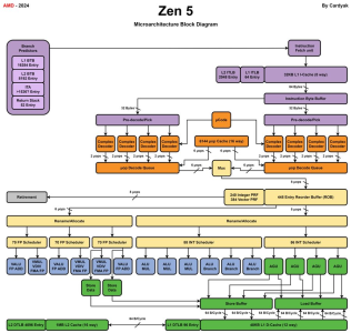

Another thing is the unified scheduler for ALU caused some additional cycle in some cases but the advantage is that AMD could leverage a smaller PRF across 6 ALUs
Int PRF increase was a grand 16 entries only which is very surprising. whereas FP PRF doubled. Also no change in the number of available ALU scheduling entries (it decreased a bit actually but it is shared with AGU in Z4).

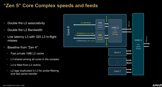

L2 to L3 still at 32B/cycle which is another factor. I thought this would finally be 64B/cycle
The 32B/cycle fabric which on fclk of around 2000MHz remains a key factor with latency, Strix probably have a much lower fabric clock I imagine, inter CCX latency is not addressed
I had hoped that at least L2 goes to 2M or increase the BW from L2 to L3, if it is 64B/cycle they could make do with 1M L2 and have access to the massive L3 including V Cache

My humble observation: Combined with what AMD has publicly stated about Zen5's core, the front end was widened in preparation for future back end work. They probably ran out of area budget to add more on the back end given the process node they are using. I suspect that we'll see the back end get more fleshed out with Zen6 on N3 family nodes, though, it won't be as pronounced as some are expecting.
IMHO feeding the beast (e.g. the cache hierarchy, etc) is a much bigger bottleneck. It's not like they didn't widen the backend (though there definitely is more room looking how Zen 1 -> 4 evolved)

L2 cache size will increase I think. 1 MB is unchanged from Zen4.
For comparison, the ARM Cortex X925 can be configured with upto 3 MB if private L2.
Intel's cores also have larger L2s iirc.

Balooning the L2 doesn't work as Willow and Zen 4 show.

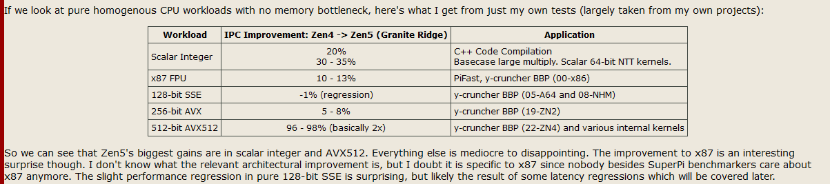

In-depth core analysis from Y-Cruncher author (Alexander J. Yee) http://www.numberworld.org/blogs/2024_8_7_zen5_avx512_teardown/
From the developer standpoint, what this means is that there quite literally is no penalty for using AVX512 on Zen5. So every precaution and recommendation against AVX512 that has been built up over the years on Intel should be completely reversed on Zen5 (as well as Zen4). Do not hold back on AVX512. Go ahead and use that 512-bit memcpy() in otherwise scalar code. Welcome to AMD's world.
It is possible AVX512 might matter soon enough.
Looks like a heavy memory bottleneck issue as found by David as well.
Similarly, the regression in 1cycle SIMD instructions also noticed by David. But seems this is a new hazard that could be resolved not some major architectural limitation in future uarchs
Heavy focus on AVX512 while no focus made to 128 bit and 256 bit instructions.
Likely that another 1MiB of L2 would have helped to get some extra perf, it is not an overly thirsty chip. But the fabric really needs an overhaul.
