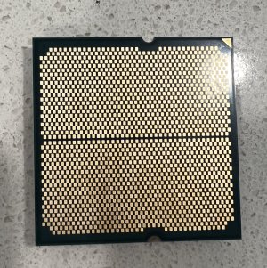

Welp, my 7950X died. I wasn't aware of this issue until I looked it up after my CPU died. I built the rig with ASUS motherboard around five months ago. I set the XMP to 6200 and left all the other settings auto and called it a day. Now the CPU is dead, if I put the 7950X into any other AM5 mobo it doesn't work. I think the auto SOC voltage was 1.4. I should've checked on these things but too late now. I filed an RMA to AMD and in the meantime, I'm using a 7600X from a secondary rig. For the 7600X I manually set SOC to 1.1v.

From what I've read even manually setting VSoC isn't fool proof. Make sure you monitor HwInfo and report back. Curious if the VSoC manual setting is actually being respected by your mobo.
According to Hwinfo, it doesn't go past 1.1. Here's a photo of the bottom of the 7950X, some of the gold markers are more brownish/darker color.

Wow. 1.4V is too much for these chips??? Maybe everyone with ASUS mobos should check their CPU undersides to see if there is anything cooking down there.
Yes. Most people who hand-tune their RAM don't need anywhere near that much vSoC to get good RAM overclocks on this platform, so the idea that anyone needs 1.4v for EXPO/XMP is a bit ridiculous.

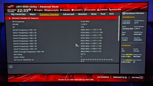

Put BIOS 1412 on my Crosshair Extreme X670E. Applied all of my 1410 settings. Still have only the V-Cache CCD enabled. Took a look at the SP rating of it while I was in there. It's an overall 97. That is. if SP ratings are to be trusted.
Curious to know what 7800X3D SP ratings are.

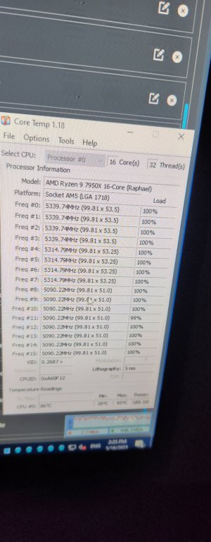

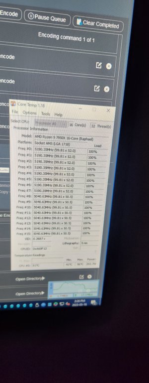

Built 2 7950x rigs recently for AV1 encoding. Comparing to my 5800x desktop, they've been really, really good. At preset 8 and QP 34 the 5800x totals around 90fps and the 7950x about 280-330fps, despite having double the cores it's over 3x as fast. Must be the zen3 vs zen4 architecture, cache, clocks peed and maybe avx512 differences. I'm using the SVT-AV1 encoder in FFmpeg.
For the first 7950x I'm seeing a allcore clock of 5.3ghz on the first chiplet and 5.05ghz on the second.
For the 2nd processor I'm seeing 5.3ghz on the first chiplet and 5.1~ on the 2nd. Are they good speeds? Also the first cpu is around 91c~ and 86c~ for the latter at a ambient temp of 24c.
