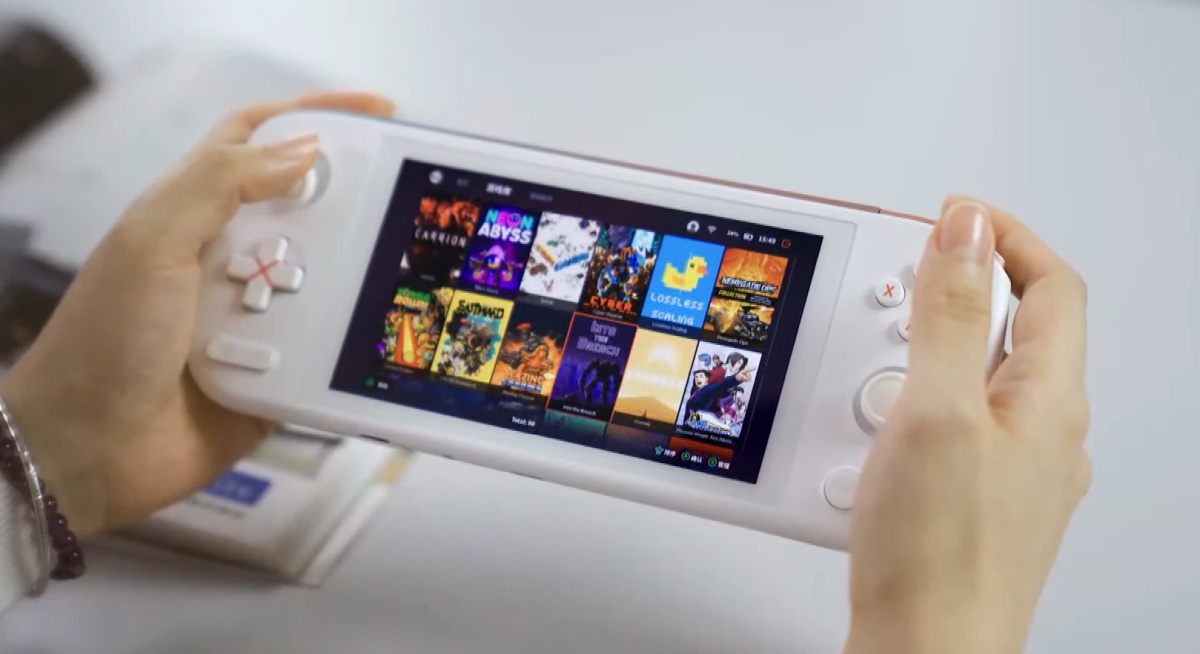

Looks like those who want to focus on Mendocino's (lack of?) gameplayability can do so on AYA's upcoming Neo Air Plus:
On a Chromebook people are missing the point, but yes, on a "gaming portable" it makes more sense. But it can also be justified if it's to play older and simpler games in low resolution, and emulation.

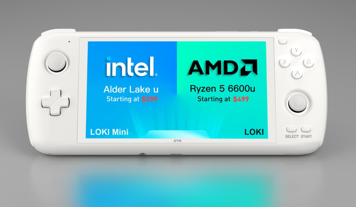

Looks like AYN will release a cheap competitor with Loki Mini ($299) offering the choice between Pentium 8500 and Mendocino. That should make all kinds of comparisons easy.
Reactions: lightmanek
gdansk
Feb 8, 2011
2,891
4,365
48 EU @ 800MHz on the Pentium 8500 is about 600gflops.
2 CU @ 1600MHz on Mendocino (van Gogh like clocks) would be about 400gflops. That would actually be less GFLOPs than the 4 Zen 2 cores in van Gogh.
But maybe AMD used 2 CU clocked high compared to van Gogh (2.4GHz?) to match their competition. Or maybe they don't care about matching their competition.
