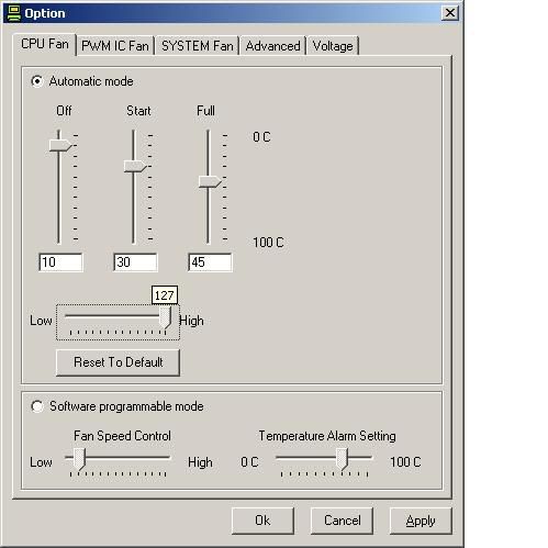

I have the fan of which you speak!!
And here is what I say(someone who has teh fan):
At first i thought it SUCKED, it twas quite LOUD...but not as loud as stock fan. Then I realizded something, it was set to 125% fan speed!!!
Afte realizing I set the controller to Auto and I cannot hear a THING!!! SO silent, its scary. Additionally, it cools just as well.
So, in order to get it ot be quiet, you have to turn down teh speed....liek most fans....so it prolly does'nt matter

Originally posted by: Neptune3000
Originally posted by: Operandi
There was a post asking this exact question literally 2-3 days ago, learn the search feature.....
I agree with klah those specs are compactly meaningless, as are the specs on ever Tt fan I've seen.
Neptune3000, 125% isn't possible.
http://img.photobucket.com/alb...0/Neptune755/fanny.jpg
u were saying?
that's w/ the DFI smart guardian u can ask someone here to confirm...
HEH
The only way to run a fan past 100% is to give it more the 12v which I don't think is possible.
