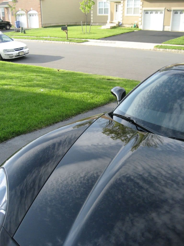

BTW, this was my car after I took delivery. Brand new :(
