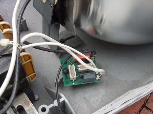

This thing has been a real prick. Spent all day yesterday trying to get it to work with no success. Had everything wired up correctly. I was convinced that the ballast was bad (even though nothing would indicate that there is anything wrong with it). So I left it alone for a few hours. Came back, plugged it in, and it fired right up. Damn thing has a mind of it's own.
Ignitor installed:

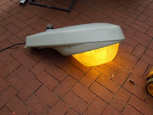

Lamp igniting:

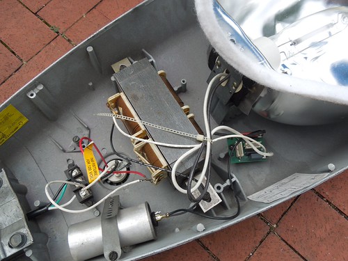

Warmed up:
Maybe it's just me, bit it seems a bit dim for a 250w. This is typically the sign of a bad ballast capacitor, but I checked it with my multimeter and it seems to be OK.
Now it will sit in my garage. :p

Do you have an ammeter? That should be the best way to find out if your cap is going bad, as it mainly is there for power factor purposes with that magnetic ballast. Do you have the specs for what resistance you are supposed to see across the ballast?
Used a multimeter to check both the capacitance rating and the resistance. Seems to be OK.

As far as making sure your light is working correctly, I would get access to an ammeter and measure it's current draw. Most electronic ballasts I have seen label the power factor they are supposed to run at, not sure if that magnetic ballast has that, but should be easy enough to find.
Once you have your measured current draw and line voltage, you can use ohms law to make sure it matches up with the power factor of the ballast, and lamp combination.
