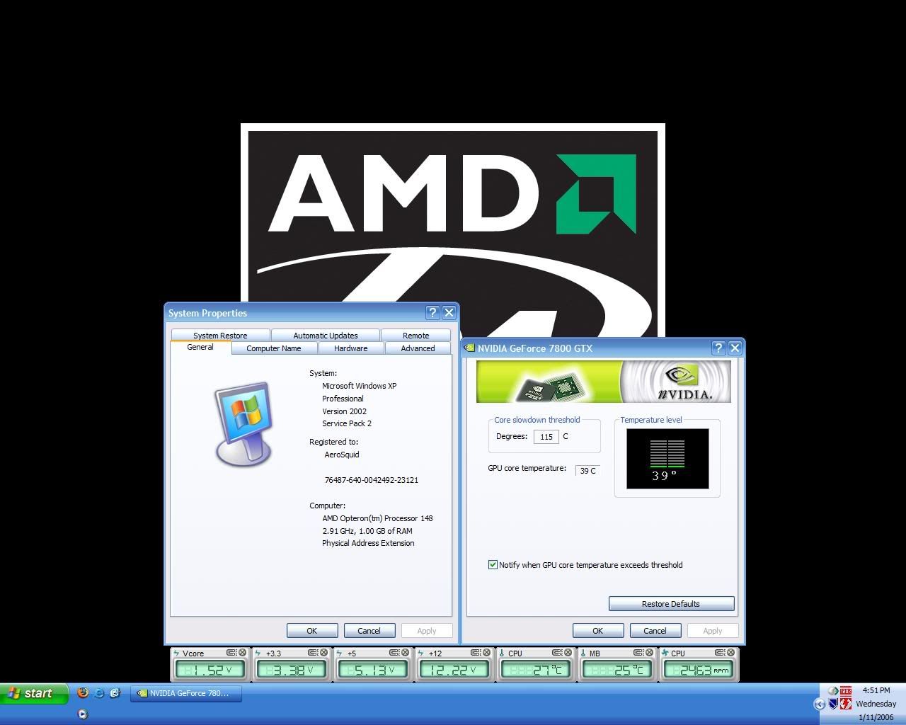

i have an opty 148 with an SI-120 @ 2.95mhz It idles @ 29 and maxes out at 42. it sits inside a CM Stacker with a crossflow fan. Myabe you should look at your overall airflow through your case?
