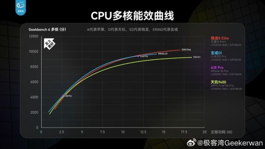

Turns out the "flagship" Xiaomi chip is just one, the Xring O1
Meanwhile, it is confirmed the following specs:
1+3+4 CPU,
1x Cortex-X925 @ 3.2GHz
3x Cortex-A725 @ 2.6GHz
4x Cortex-A520 @ 2.0GHz
GPU from Imagination Technologies
5G modem from Unisoc.
Expected performance: Dimensity 9200+
Aparently UNISOC helped with the development, so expect UNISOC having a similar CPU structure with slower speeds, but with Mali GPU in a future to call it their "flagship".
Expected performance if ends to be real: Dimensity 8300

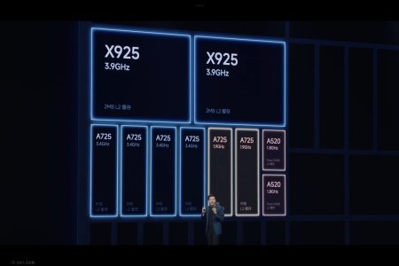

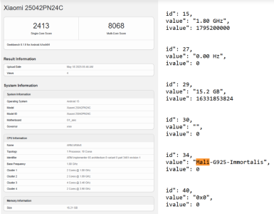

And this is interesting... it turns out that the configuration was a 10 core chip!
2 Big cores @3.9 Ghz
4 Mid cores @ 3.4 Ghz
2 "Small" cores @ 1.89 Ghz
2 Small cores @ 1.80 Ghz.
Is pending if the 2 "small" cores @ 1.89Ghz is an A7XX or an A5XX.
If is the first is basically what Exynos 2500 could have been.

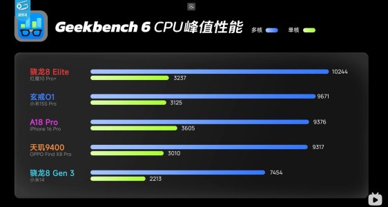

Also the scores CPU wise is on par with Dimensity 9300+/9400e!!! Is practically near a flagship!
And... Inmortalis? Wait... something is off... unless... Xiaomi always had a plan to release not one but two processors with different targets?
Meanwhile if that is true... UNISOC rumor might be real too.

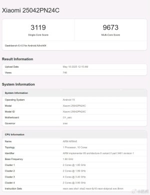

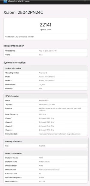

This one performs much better with 3119 ST scores. Due to using external 5G modem, it seems Xiaomi is stretching the power limit with first true SoC for Android phone. The specs are better than D9400:
  • 2 x X925 3.9GHz (2 x Prime cores)
  • 4 x X4 3.4GHz ? (4 x Performance cores)
  • 2 x A720 1.89GHz ?
  • 2 x A520 1.8GHz ?
  • Mali G925 Immortalis MC16 16CU (extra 4CU than D9400)
Of course, N3P-powered D9500 is coming soon with SME support; so far what I heard X930 with SME will once again leapfrog X925, we shall see...
  • 2 x A520 1.8GHz ?
Can be 2X A720 1.89 and 2X A720 1.8
Unlikely if both cluster are A720 @ similar speed, then it should be 4 x A720. At first, I thought it could be using A725/A525 but since performance cores are likely using X4; then it seems unlikely also.

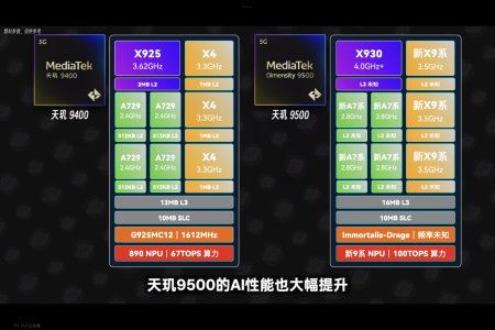

Maybe that's why Alto cores exist in upcoming D9500; here is the up to date leaks about D9500:
Reactions: 511
Is that 100 TOPS NPU 💀.
I have seen SoC that uses same cores but different V-F Curves into different cluster.
LMAO I was half right they definitely used finflex here for different V/F Curve.
