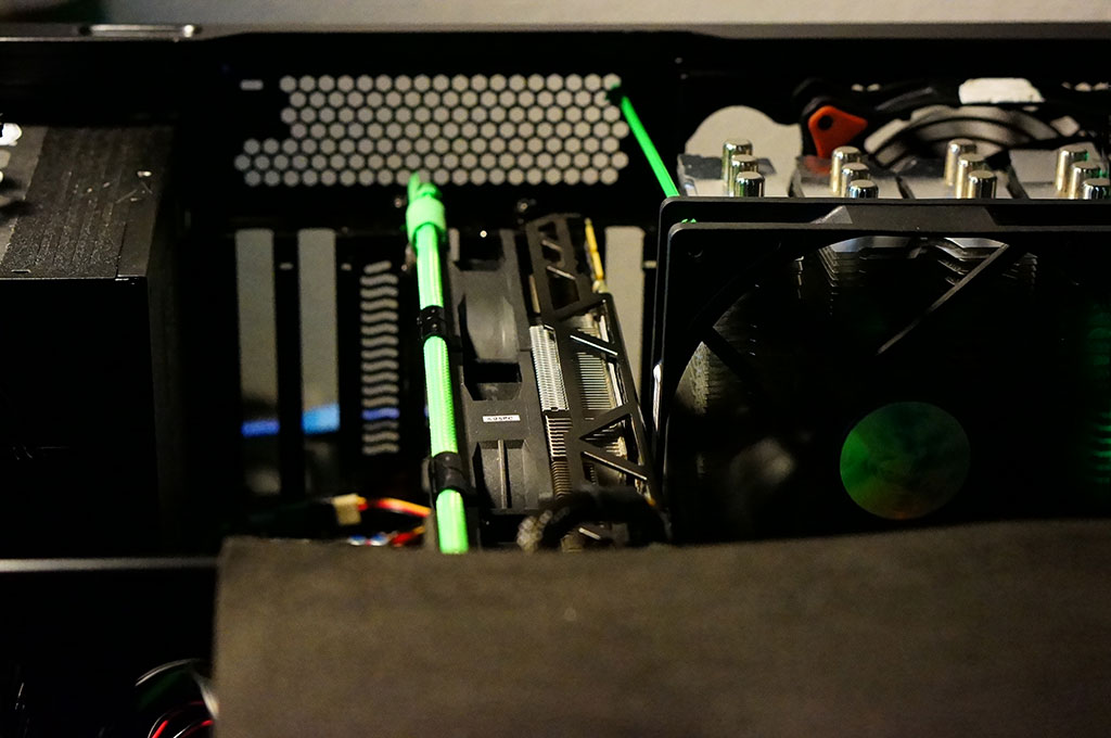

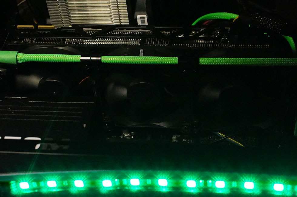

Result
Now all I needed to do was to connect the 120mm fans to a PWM Y-cable, connect the Y-cable along with four case fans to a 5-way PWM splitter, and connect the splitter to the GPU fan header.
Here it is, sitting happily inside my modded Core V21:
The cooler takes just under three expansion slots, allowing for the fourth expansion slot of a MicroATX board to still be used for a WLAN card (for instance).
I can now adjust the fan profile of the graphics card and case fans directly with MSI Afterburner. Of course, the great advantage here is that case fans will be adjusted according to GPU temperature and synchronized with the GPU fans, which means the case fans are actually doing useful work by cooling the one component that uses by far the most watts.
Here's a quick video of the setup, hopefully you'll be able to tell how quiet it is. There's static noise inherent to the crappy smartphone microphone, it's the only thing you hear in the beginning, please pay no attention to that. After the first 25 seconds of idling, the the fans will slowly spin up as GPU temperature rises while running Unigine Valley. You may have to turn up your speakers a bit to hear the fans.
XFX R9 390 modded cooler noise test (Youtube)
The most prominent fan noise comes from the front fans since their dust filters amplify noise. The rear, top and GPU fans are a little quieter. Temperature settles at about 76°C in a few minutes, with fans running at 73%. According to the GPU-Z sensor, the GPU fans are running at 1000 RPM (the maximum RPM of BeQuiet 120mm seems to be about 1400). The 140mm case fans have a maximum of 1000 RPM, and here they're running at about 700 RPM.
And that's the length of that project. The whole thing took me only a few hours, and I have to say I'm quite pleased with the result!

Well this didn't go quite as planned.
I had a failure and a success. Modding with the Nocuta NF-F12's was a fail. But I did manage to reduce the temps by about 10 C by making several other changes. That subsequently lowered noise levels. I'll describe that in a follow up post.
My original plan of attaching the Noctua NF-F12's to the R9 390 proved to be more difficult than I'd anticipated. I can now see why the BeQuiet Pure Wings fans are a better choice, as you rightly pointed out, with their open area around the 120mm mounting points.
Also the R9 390 rad grill had a kind of raised ridge in the middle on one side, and then a couple of raised tab-like things protruding on the opposite edge, that made it really difficult to seat the fans. I tried to accommodate that on one side by notching the NF-F12 fan to fit
and initially I was thinking big win, as it also lined up holes perfectly on the other side.
But it resulted in the fans overhanging on the PCIe side of the rad grill. The fans were fairly centered on the grill, and I thought I'd left enough clearance on the PCIe side, but the fans were overhanging too far on that side.
My motherboard is an Asus Z87 Plus. It has PCI legacy slots under the PCIe slots. PCI slots are raised by about maybe half a centimeter higher than the PCIe slots. So my fans would have had to be flush with the rad fin's edge on that PCIes side of the card in order to still fit into the 'recessed' PCIe slot on the mobo. But I wasn't even close. With my new fan placements on the card I didn't even contact the PCIe slot. I was out by at least a full cm. Big disappointment. I should have paid attention to where the stock XFX 390 fan shroud lines up on the PCIe side of the card. It is only as far as the rad edge, leaving plenty of room for the card to slot in.
It was just an oversight on my part and a big fail. It was a combo of both the fan choice, my layout and the mobo layout. I decided after spending a few hours just getting to this point that trying any further to re-align the Nf - F12's was a headache I didn't want. Maybe someone else would have gone further with it, but at that point I decided it just wasn't worth it with the NF-F12's.
But when I look at your layout picture it makes me think that even if I'd used the 120mm BeQuiet Pure Wings I still might not have cleared that PCI slot on my mobo. So in this case the mobo may be limiting the fan choice to a 92mm or lower.
For the record, here's what it looked like from the side of the card where the 9\6 pin power is. You can see I just didn't have room to go out another cm or further with the fans and make up the difference that I needed on the other side where the PCIe tab is.
So I pulled the fans off and put the stock fans back in.
One thing I wanted to point out is the terrible stock thermal paste application. Wow! This thing was wearing a sweater.
Cleaned up
I'll do a follow up post here shortly to show before and after case pics and explain what I ended up doing to reduce the temps by 10 - 13C. I need to save this, disconnect and then take pics of the new case setup now that I've run several benches to confirm the reduced temps.

Here is a pic of the old case layout before attempting the R9 390 fan mod. And yes, I know it's a cluster***k Macgyvered looking mess. The most glaring problem was having a vertical fan off of the bottom drive cage blowing directly into the path of a horizontal intake fan that was blowing air into up to the card. My reasoning on keeping the two drive cages was to try and separate the drives (WD Blacks) that were getting in the upper 30's. I realize now that the reason was the cage orientation and layout, overall poor case setup, and poor circulation. The insulated white wires coming off the top of the card and going out the back of the case were just temporary open junction thermacouple sensors taped to the backplate while I measured temps. I used an Amprobe HVAC probe. (btw those on screen temps of 26.0 and 26.5 are with PC off)
And here is the new case layout. A much cleaner layout with better overall circulation.
You can see I ended up taking the 390's fan shroud off
