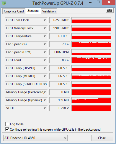

i think your card is overheating and down-clocking itself. take a picture of GPU-Z's Sensor tab while you have something running in window mode like a game or Unigine Heaven Benchmark (anything that stresses the GPU) and upload it here.

thanx for ur reply....... yeah i guess u r right :( but actually i thaught that hd 4850 should give me something more then gt 240 thats why i replaced that but it seems like a worst decision....... and i dnt think so that m out of vram bcz during my laggy session in games i checked gpu z and it shows that i have 100 mb still spare.....

well the temps and clocks look OK, your cards is not throttling. on the other hand you did run out of VRAM. time to lower resolution and remove some special effects.

What you describe is what happens when you run out of vram. We typically refer to it as hitching.
AMD's drivers are fine, they are not the issue in what you are describing.
I would run MSI Afterburner with the big graph up and then go and play. When the hitching starts, tab and and look at the graph and see what it shows. If it shows 90% or more memory usage, you are running out. What happens is the game will go to allocate a chunk of memory and there wont be enough. So older data in memory has to be cleared out first, and then it can allocate it. This causes the hitch. No graph will actually show 100% utilization for memory.
